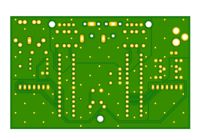

Reply 27 of 39, by aspiringnobody

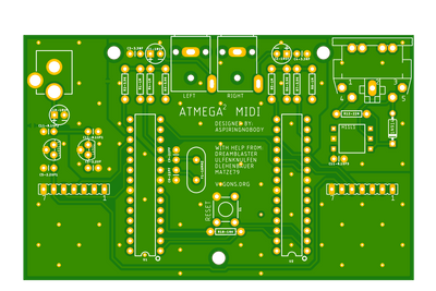

The original Github design connects the GND pin of the screen to an unused digital I/O of the ATMega that I assume is pulled low (he says it reduces noise from the screen -- on my breadboard it's hard to say). I'm unsure if this is necessary now -- I've used an entirely separate voltage regulator that just powers the screens. Should I still ground the screens to the ATMega or should I try it like this first? Also should I separate the ground planes for the digital section and the screen section? It would probably mean I have less overall ground coverage.
EDIT: I went ahead and separated the ground planes. Can't hurt, right?
It forces all the (digital) ground through a narrow strip near the left ATMega but I added some VIAs to attempt to share between both layers. Actually, I added ALL the VIAs. Way too many. 10x too many.

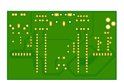

Reply 28 of 39, by aspiringnobody

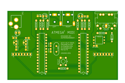

Alright here's the first attempt at making the board match the dimensions of the Chillbox enclosure from Serdashop. I'll have to see if I can convince Serge to make a top shell with cutouts for the screens 😀. I'll eventually order some of these PCBs just to confirm it will fit in my Chillbox.
I still need to verify the schematic, add stitching vias, and trim the audio ground plane since there's so much unused space at the top of the board. I think I'll be able to order some PCBs and get these started in the next few days. I'll probably order some of the more compact version from the post above as well for people who either want to make their own case or aren't going to use a case. It's got smaller overall dimensions, so it is probably better for people with a 3d printer.

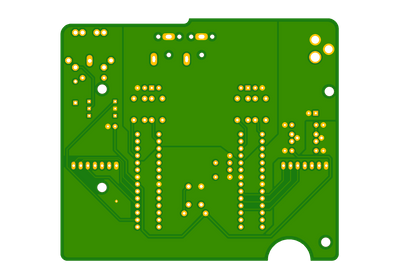

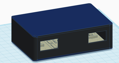

I've reworked the board so that it will hopefully fit into the Chillbox while still using the smaller layout.
Here's a first draft of the case. The two holes on the front are for left and right channel's displays:

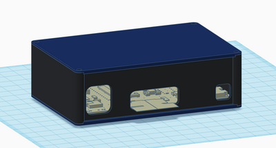

The holes from left to right on the rear are for MIDI, RCA audio, and power:

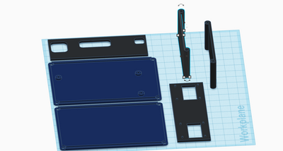

The case prints in six pieces and is held together with four screws from top through to the bottom. If I keep with the blue and black colors I will probably use brass screws. There will be rubber feet on the bottom to keep the screwheads from scratching the table:

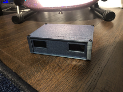

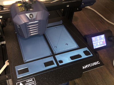

First full case print is almost done! Just a smidge of under-extrusion to fix but other than that making good progress learning to 3d print!
Reply 37 of 39, by aspiringnobody

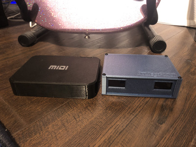

First case assembled. I should get the final revision PCB by Monday and as long as the mounting holes line up it’s time for assembly! The second case is printing now in black. I’ve got silk blue, regular black, and regular white as options for cases. I’ve included a picture with the Chillbox M for scale.

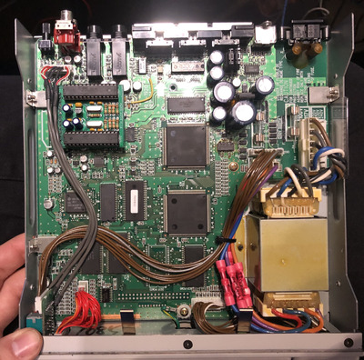

For those wondering my prototype wavetable module ended up in my Korg NS5R and works great. You can even send the midi control messages for the quirk modes to the module inside the Korg and they work perfectly!

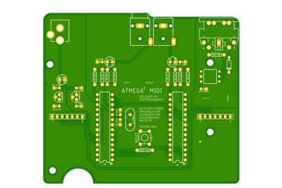

Well, the project is finished. The final board revision is completed. The headers will be on the board for the screens but I won’t be using them sadly. Independent power supply or not — grounded to the ATMega or to the board — the level of digital noise they put on the audio output is simply unacceptable.
I^2C is a potential solution but that would require refactoring the code and redesigning the board and I’m just not going to do that. The bits and bobs are there for people who care about the screens — but I want a low noise floor so that’s what I’m going to focus on.
I have some screens in stock so I can provide them if anyone wants. I suppose I can even include a blank front panel and one with the screen cutouts as an option.
If I were going to do it again I would have added a third microcontroller to just handle the display. But hindsight being 20/20 I think I’m going to put this one in the books and move on.
