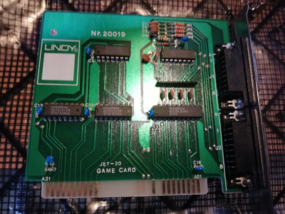

I also believe to see an NE558 timer IC and the required glue logic.
These ~5 TTL ICs on the left.. My Lindy gameport card has them, too.
Edit: Here it is (hi-res). Please have a look at these wonderful discreet parts!
Even the little charging caps for the 558 timer's time base are visible. ^^
