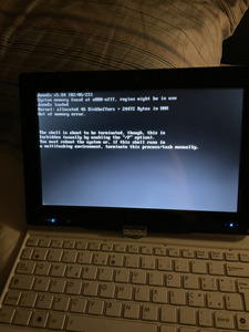

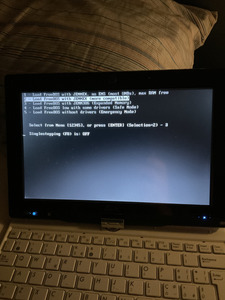

Reply 221 of 915, by Yoghoo
matti157 wrote on 2023-03-20, 23:32:
Do you have a little guide for freedos?
At startup it gives me the message "jload: versions of Jemm and Jload don't match"
The versions from Freedos are older and do not work with sbemu. So use the files (jload, jemm) from the zip file. You have to change the path in the config.sys and autoexec.bat to where you extracted the zip file to (f.e. c:\sbemu).
Reply 222 of 915, by matti157
Yoghoo wrote on 2023-03-20, 23:53:
I found only jemmex.exe under the bin directory of freedos. Updated it and now it no longer boots.
Do you know the paths of where to place the other exe's? Via search I can't find anything

Reply 223 of 915, by L4MD4
matti157 wrote on 2023-03-21, 00:07:
You don't need to overwrite the original JEMMEX.EXE, that came with FreeDos.
You can just leave the new one in "C:\SBEMU", if booting to "C:".
For a simple test, of SBEMU, you can edit FDCONFIG.SYS.
Find the line "DEVICE=\FREEDOS\BIN\JEMMEX.EXE" and place a ";" in front of it (this "more or less" disables the line).
Then create a new line for the JEMMEX.EXE in the SBEMU folder.
----Example----
;DEVICE=\FREEDOS\BIN\JEMMEX.EXE
DEVICE=\SBEMU\JEMMEX.EXE
Once booted, change directory to SBEMU and proceed according the the README.TXT file.
Now, concerning the boot issue, you could try "DEVICE=\SBEMU\JEMMEX.EXE NOEMS NORAM".
That is often the first line of defense, when working with JEMMEX problems.
If you find everything works out for you, it is probably "then" okay to move everything to C:\FREEDOS\BIN. Maybe just rename the old JEMMEX.EXE , to JEMMEX.OLD.
Alternatively, you could add "C:\SBEMU" to the system path, in FDAUTO.BAT.
----Example----
SET DOSDIR=\FREEDOS\BIN
SET PATH=%DOSDIR%;\SBEMU
Now you don't need to move anything to "C:\FREEDOS\BIN".
Note: The system path does not apply to things loaded by FDCONFIG.SYS.
You still need to specify the path, in that case.
