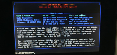

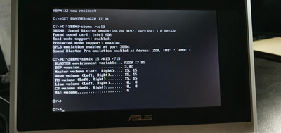

tercio wrote on 2023-04-01, 13:23:One Must Fall2097 now works great in my eeepc 701!!!
Care to detail how you got One Must Fall working? What is your HDA sound card and settings? I've tried many times with different settings and failed. This is what the latest SBEMU (beta2c) detects my Soundcard as:
SBEMU: Sound Blaster emulation on AC97. Version: 1.0 beta2c
Autodetecting/testing available outputs/soundcards, please wait...
1: Intel HDA: Intel SKL (Kabylake-LP) (80869D71) -> Realtek (10EC0256) (max 192kHz/24bit/8ch)
Autodetecting finished... Exiting...
OMF works fine without sound, or with PC speaker sound. It freezes, with black screen upon running with SBEMU loaded. One Must Fall configures fine with its SETUP.EXE program for: Sound Blaster, SB Pro, SB16, Sound Blaster Clone, regardless of IRQ 5 or 7 chosen.
I've tried:
1. Running two different versions of OMF; ver. 1.1 and 2.1.
2. Restubbing the MASTER.DAT file which is really just a DOS4Gw / DOS 32a protected mode .EXE, and deleting OMF.EXE in version 1.1.
3. Restubbing the OMF.EXE file from version 2.1 which is a PMODE 1.0 protected mode .EXE with DOS4gw and / or DOS32/A.
4. Changing various SBEMU settings such as IRQ 5 / 7, T1, T5, T6, /rm0.
5. Tried Baron von Riedesel's compilations. The same behavior. Hard freeze, reboot required.
6. Also tried stamasd's hints by setting SET DPMIMEM=MAXMEM 16383 and SET HDPMI=2048 in my SBEMU .BAT file. No effect.
It's not a video issue, as the game runs in only 320x200 and runs very well without sound.
Who else, if anyone has gotten OMF2097 working on Intel HDA?
One more test that I did tonight. I went back to the Optiplex 3050m system and replaced the CPU: instead of the one I tried at first (i5-6600T) I installed a i5-7600T. That was the only change I made.
SBEMU does not work at all anymore. It gives me:
internal buffer overflow
system halted.
After that it requires a power cycle.
I tried it in various ways, enabling/disabling EMS, enabling/disabling UMBs in jemmex options. No matter what, even if I try to load it in conventional memory with no UMBs, it gives me the buffer overflow error.
Again, the only change I made was replacing the CPU with one from a newer generation (Kaby Lake instead of Skylake). This system can take either. The chipset is H110.
Other than that, the system works fine in Windows.
The testing was done with SBEMU beta2c and the other binaries from the beta2 package.

zyzzle wrote on 2023-04-04, 00:59:Care to detail how you got One Must Fall working? What is your HDA sound card and settings? I've tried many times with different […]
I've tried:
It's not a video issue, as the game runs in only 320x200 and runs very well without sound.Who else, if anyone has gotten OMF2097 working on Intel HDA?
OMF2097 Version 2.1
Intel HDA (EeePC 701)
Twitter @tercio_miranda
I've tried:
tercio was using the temp release version that fixes Epic Pinball, did you use that too? I tested the game of ver 2.1, using /t5 and SB Pro in setup, and no problems found on my TP T540p, i7 4710MQ Haswell CPU. I'll do more test later.
