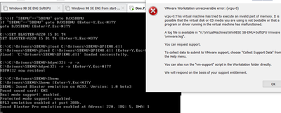

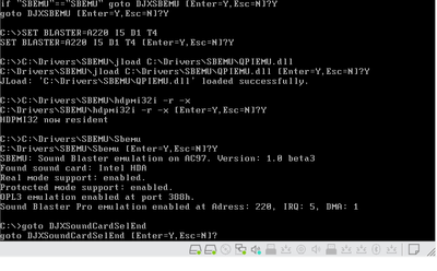

Because nobody responded, i tried it Virtual box..
i used existing MSDos/ Windows 98 virtual. added additional Menu Item for SBEMU.. In virtual box set sound card to AC97.. used SB emu, card was found.. and sound and music is working in Vbox.. Im not fully sure about game speed and sound latency but SB emu is working with Virtualbox that is good..
Update: Duke3D/Quake are fine too and there speed is right. Warcraft 2 - Sound card, it cant detect SB16 but SB is fine for FX, for music SB16 is fine.
As usually i hit other Vbox problems, it has some strange problem with FileWizzard and Dos Navigator, keyboard always starts to behave funny in these after some time (TAB key is stopping to work).. But its maybe because im using quite a lot utilities in my configs and autoexecs..
I found some old Jemmex.exe line which i used, maybe it could be better:
Jemmex.exe 32768 NOVME A20Method:Fast SB SPLIT RAM VERBOSE
Next step would be trie Vmware.. its usually better for DOS than Vbox..

Reply 734 of 1291, by ruthan
I had some beginners problem.. i always get stuck on such things.. but maybe im not alone..
I had in autoexec line:

I set machine for Win98.. so its using ES1371 sound device.. when SB-emu is loaded, last line, im getting some brutal VM crash.. I experimented with JEMMEX line parameters used it eveb without them too, it not helped.

Vmware workstation, With HDaudio on 9900K CPU.. no more crash.. SBemu is able to find Hdaudio device, see picture.. All tested with IRQ5, im quite sure that some older games, especially older ones could run with IRQ7.. because it was original SB IRQ, if im not wrong..
But Doom is not running.. its stuck on this message:
SB isn't responding at p=0x220,i=5, d=1
But there are other related settings for sound in *.vmx file like sound.pciSlotNumber = "XX" etc..
