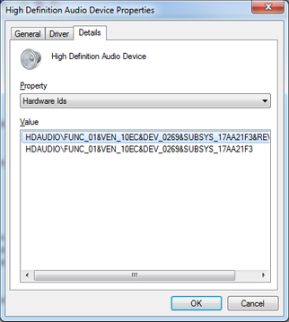

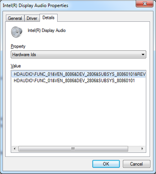

Reply 648 of 1378, by Srandista
Sure, here you go! There are 2 audio devices, but I assume, that sound for speakers is going from HD audio one.
27.87 KiB
1983 views
24.25 KiB
1983 views

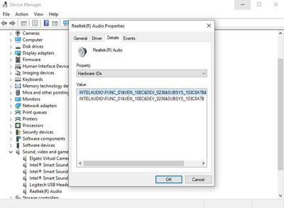

Reply 649 of 1378, by Biomecanoid
Srandista wrote on 2023-05-12, 21:33:
Nice it seems that I have the exact sound card on my Lenovo i5 Laptop. Now the Intel sound card should be your HDMI port
Reply 650 of 1378, by Srandista
Biomecanoid wrote on 2023-05-12, 21:38:
Exactly. And since I didn't have external monitor connected, I assume it's using that HD audio card (SBEMU identified it as Intel HDA). But wanted to add both of those HW IDs just to be sure 😀

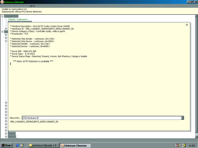

Reply 655 of 1378, by Chuck
Biomecanoid wrote on 2023-05-11, 13:13:
Chuck wrote on 2023-05-11, 11:25:
Great program but it's unfortunate that windows won't start with jemmex loaded. Would be great if it could not interfere because the games that needs it could be launched just creating a custom autoexec.bat configuration for them in their properties, so when you launch them windows will go in ms-dos mode and launch the game.
Can you post your sound card's hardware ID ?
I believe everybody who has managed to make sound work in DOS should post their sound card's details, device manager will give us very precise information
Sure, although I believe Windows 98 device manager won't be of much help regarding hw Id, so here is a screen from unknown devices program.
Reply 656 of 1378, by Biomecanoid
Chuck wrote on 2023-05-13, 18:33:
Perfect hardware id is just there in your photo. So is sound working for you ?

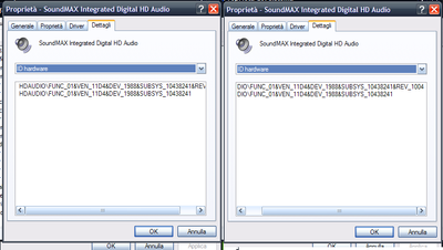

Reply 658 of 1378, by VenomSpark
Biomecanoid wrote on 2023-05-13, 18:53:
VenomSpark wrote on 2023-05-13, 18:27:
hi there! fantastic project finally that i was waiting for years! but... not working for me :( please help me! […]
hi there! fantastic project finally that i was waiting for years! but... not working for me 🙁 please help me!
my sys is:
AMD Athlon 64 x2 4600+ 2.40ghz Windsor
6GB DDR2 (3X2GB)
Sapphire Radeon HD7850 OC 2GB
ASUS M2N
FreeDOS 1.3
The fact is i followed a YT guide, extracted files on C:/ and edited all fdconfig.sys and fdauto.bat, when i select the mode it says all is working and emulated, even games setup recognize/thinks i have a Sound Blaster but i get NO sound or music! is all muted.. ofc speakers works.
by far i know from this mobo is from 2006, have a nForce 2 chipset (i think) and the audio integrated chip should be an Azalia/SoundMAX.
Please help me how why i don't hear anything on this machine? Using last sbemu and jemmex included in the pack.
Please post the hardware id of your sound card
here it is, thanks for reply hope can help! 😀
    37.81 KiB
    1764 views
Reply 659 of 1378, by Biomecanoid
VenomSpark wrote on 2023-05-13, 19:57:
my sys is:
6GB DDR2 (3X2GB)
ASUS M2N
FreeDOS 1.3
This is directly from github:
https://github.com/crazii/SBEMU
SBEMU
Sound blaster emulation with OPL3 for AC97.
Supported Sound cards:
Intel ICH / nForce
Intel High Definition Audio
VIA VT82C686, VT8233
SB Live/Audigy
The VT82C868 & ICH4 are tested working on real machine.
ICH & HDA tested working in virtualbox, not verified on real machine yet.
HDA tested working by community.
