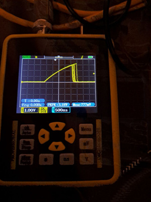

I have rewritten code and started over countless times and maybe this time this is last time. I ditched Arduino IDE in favor of getting all interrupts and watchdogs totally off. Other core runs now only loop with pure assembly without any interruptions. This was needed to get StereoIn1 (Crystal Dreams, Inertia Player) to work. Signal for channelselection is ridiculous (scope image in attachment) and sample read must be very fast. I didn't get it to work until all my software tweaks and added quite strong pullup resistor for channelselection-pin. It is much smaller and shorter than DSS-signal, so now DSS works even more realiable, as it works too without any interruptions in very tight loop. Now Crystal Dreams works 44.1kHz at Stereo (at least with my Compaq Contura 420C 75MHz) and it sounds stunning.
This detects Covox/DSS/StereoIn1-mode automatically, but StereoIn1 some software (Crystal Dreams and Inertia Player at least) puts DSS pin to HIGH, so it must be reset somehow to get back to normal Covox-mode. It cannot know if DSS signal is HIGH because DSS mode is needed or if it just because something else raised DSS-signal. I cannot force it to normal Covox mode after StereoIn1-mode, because then it wouldn't work if DSS-stuff is started after that.
