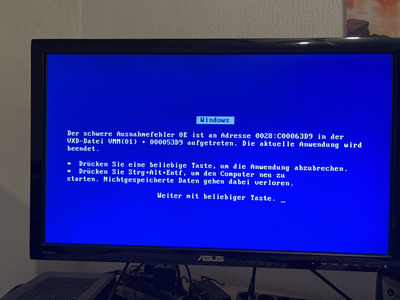

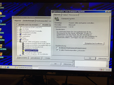

I'm looking for the correct Windows 98 SE driver for my card, apparently its a Soundblaster AWE 64 Value, model number is CT4520.
Tried this driver: http://www.vogonsdrivers.com/getfile.php?file … &menustate=37,0
It installs and seems to work, but the device manager is reporting a second Gameport with exclamation mark,
And its giving me VXD error bluescreen when rebooting or shutting down.
I'm mainly planning on playing games up to the late 90s on this machine including DOS games in DOS mode.
what would be the correct driver for this card or should I stick with plain windows 98 drivers?

update:
I tried uninstalling the driver and the devices but it keeps looking for the creative driver disk, I'm unable to reinstall the windows 98 drivers.
Reply 1 of 4, by Gmlb256
AWE64's gameport should have a different name in Device Manager which is "Creative Gameport Joystick". I suggest uninstalling the drivers (both gameports and sound card) in Safe Mode prior reinstallation.
Eimer wrote on 2023-05-21, 21:06:
update:
It is actually asking where the driver for the AWE64 sound card is located which also contains the necessary driver for the gameport it has. The message about the "Creative driver disk" isn't helpful and can happen with drivers from other brands.
Reply 2 of 4, by Eimer
yea I found my issue isn't hte driver, it actually has something to do with the motherboard failing to update ESCD and mixing up IRQs..
apparently the bios flash chip was changed to a different unsupported chip I'm asking the seller about it but he said he has no clue...

Reply 4 of 4, by Eimer
jesolo wrote on 2023-05-24, 21:10:
What motherboard do you have?
Some motherboards had a jumper on the motherboard to "write protect" the BIOS ROM chip. If it is write protected, then it can't updated the ESCD settings. Try jumpering it (temporarily) to not prevent writing to the BIOS ROM and see if you can then successfully update the ESCD.
its a Soyo 5BT5 rev 1.1 but the bios chip has been replaced at one point, there is no write protect as I flashed a bios already.
seems the previous owner went for a 256KB chip instead of the original 128 which messes with the ESCD flash not working.
I don't know which chip is designed for this board and I don't have the equipment to flash it. but since everything else works except for reboot bluescreens, I'm gonna leave it as is for now...
