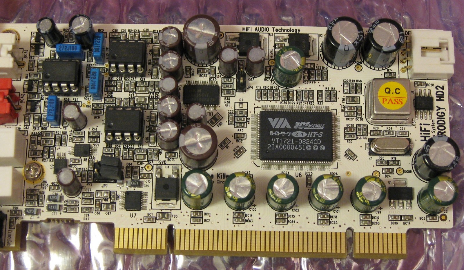

Reply 7 of 13, by shevalier
The Serpent Rider wrote on 2023-09-06, 08:55:
Sound cards on VIA Envy24 probably also have good hardware support.
It`s HBA - full software Host Based Adapter and has not any hardware offloading.
For this, it was very loved by audiophiles.
i.e. Audiotrak Prodigy HD2
Not my own, but would love to have in the collection.
