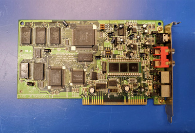

This is going to be a log of my attempts to diagnose and repair a faulty Roland SCC-1 I acquired recently.
945.92 KiB
1367 views
Initially, I tried it in a PC under Windows 95 and DOS. The card is detected just fine, produces MIDI output, but no audio output.
I tried using the DOS Roland utility which again confirmed the card was detected. Tried performing a GS reset to no avail.
Physical examination for damage only revealed a single cracked resistor (R2). It's a 1.0kΩ resistor currently reading ~1.4kΩ. However, this is part of the circuit for the MIDI input jack so not related to the lack of audio output.
Checked all the ICs for any loose pins. None were found.
Testing for shorts also revealed none. Testing various traces also went fine with no obvious faults. And checking various ICs for overheating, nothing seems to even get even moderately warm.
Next up I will focus on examining the DAC (NEC D6376) to see if there is any faults there.

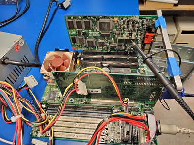

I had doubts the issue was in the audio circuit itself, since I would expect either some audio output even in just one channel. So I decided to see if the DAC itself was a the problem.
1.07 MiB
1356 views

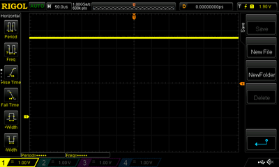

I initially tested a working Roland SCC-1 to use as a benchmark. I took voltage readings and signal readings on my oscilloscope for clock and input signals. I then did the same for the faulty card.
Between the two cards, the only difference showed up on pin 15 of the DAC, which is the signal in that runs from pin 13 on the Roland PCM sound generator (IC12).
On the good card, the signals look like this:
22.31 KiB
1364 views
51.58 KiB
1364 views
On the bad card, they look like this:
23.34 KiB
1364 views
23.92 KiB
1364 views
Basically, when a MIDI file is playing there is no stream of data being fed into the DAC, hence no audio output.

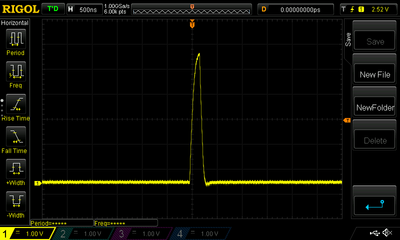

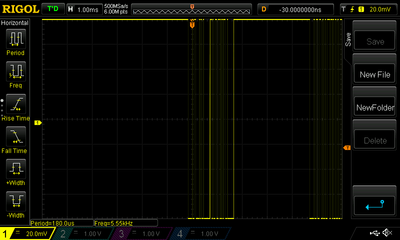

Next step I decided to test the MIDI input from the MIDI circuit into the sound generation circuit.
It enters by way of a signal fed to the sound generation control chip (IC10) via pin 67.
Probing this pin on the bad card revealed no activity when playback was stopped, but a signal when playback was started. Haven't tested the good card for comparison, but at first glance it does look like a signal is being fed into the sound generation circuit.
19.92 KiB
1357 views
22.51 KiB
1357 views

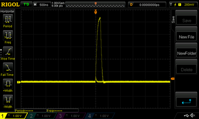

Reply 3 of 21, by Shponglefan
After a bit of a hiatus, I resumed trying to diagnose and repair this card.
Starting with IC10 (main CPU controller) I did some more comparative readings between a working and non-working SCC-1.
Pin 67 (MIDI input) with the working card while playing a MIDI:
20.48 KiB
1185 views
Pin 67 (MIDI input) with the non-working card while playing a MIDI:
19.64 KiB
1185 views
On both cards the activity indicates there is MIDI input going into IC10.

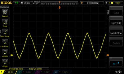

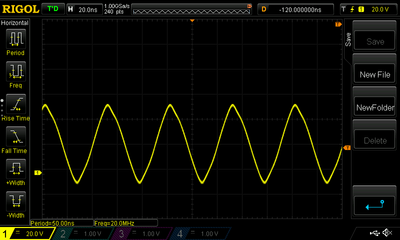

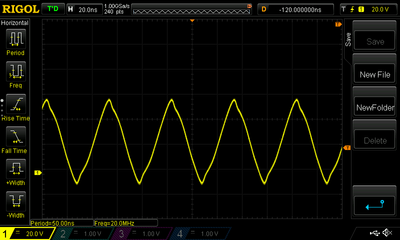

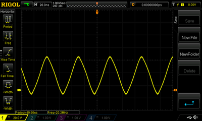

Then I did some testing on the crystal connections on pins 69 and 70.
Pin 69 (working card):
26.7 KiB
1184 views
Pin 70 (working card):
27.14 KiB
1184 views
Pin 69 (non-working card):
27.67 KiB
1184 views
Pin 70 (n0n-working card):
28 KiB
1184 views
Both cards have a working crystal with a relatively stable 20MHz signal.

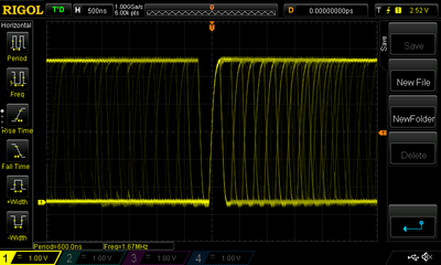

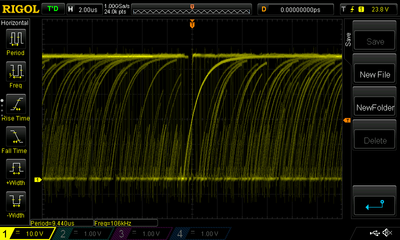

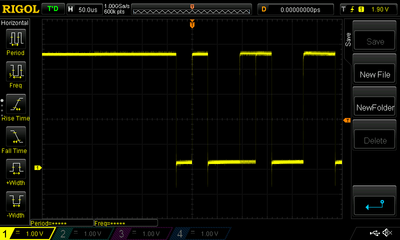

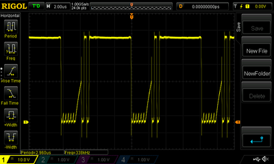

I also tested one of the data lines on IC10 (pin 13).
This is where a difference in the signal shows up:
Pin 13 (working card):
75.36 KiB
1174 views
Pin 13 (non-working card):
25.93 KiB
1174 views
There is a clear difference in signal between the two cards. The signal also changes when playing a MIDI versus not playing one on the working card. But on the non-working the signal doesn't change.
The data lines run between various ICs including the CPU, Gate Array, PCM generator and RAM. I don't know if this means the problem is directly with IC10 or possibly with one of the other ICs.

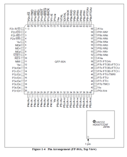

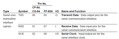

Continued to do some reading and testing related to the main CPU (IC10) chip.

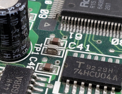

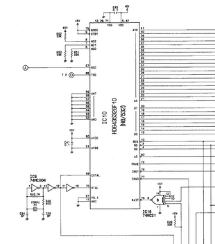

I've been trying to figure out what the various pinouts do and determining what normal operational behaviors would look like. There is a test point (TP1) on the card connected to pin 66 on IC10.
356.92 KiB
976 views
52.05 KiB
984 views
I was able to obtain the data sheet for this chip and it turns out it's the serial data transmit pin.
77.97 KiB
984 views
20.9 KiB
984 views
Probing with the oscilloscope didn't give me much. With the working card, it seems to generate activity when playing a MIDI. With the non-working card, when starting a MIDI file it seems to trigger some sort of output signal, but not sustained in the same manner as the working card.
Given this is digital serial data I have no idea what it's actually transmitting or how to interpret it on the scope. I imagine this was probably intended to be hooked up to some sort of serial interface with proper testing equipment for this chip.
I also checked pin 72 which outputs a System Clock. It reads 10 MHz on the oscilloscope (non-working card). Haven't tested it on the working card yet, but I'm assuming that is a normal reading.
