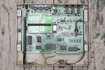

So, how Roland CM-300 is supposed to work - where on the boards are the ROM chips located - nowhere to be found?!
I don't understand, because I see no any ROMs on the pictures of what is inside Roland CM-300:

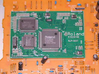

yet it has the exact same add-on (daughter) board as CM-500:
239.46 KiB

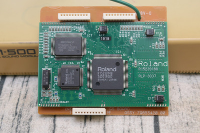

and here is the CM-500 one:
645.62 KiB

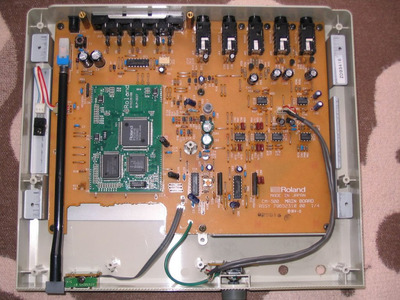

but with the very big difference on CM-500 main board the Control ROM and the SoundBank ROM are obvious:
880.24 KiB

Reply 1 of 5, by Cloudschatze
mattw wrote on 2023-10-18, 02:07:
The discrete GS program and wave ROMs are on the opposite, unphotographed side of the RLP daughterboard. The CPU (IC6) contains its own ROM.
Reply 3 of 5, by mattw
Cloudschatze wrote on 2023-10-18, 03:25:
just to say - you're 100% right - I got my hands on a CM-300 unit and desolder the RLP board to see its other side. what was the surprise is that the RLP board was not "RLP-3037" (as on the pictures I took from Internet and posted in my initial post), but "RLP-3170".
So, it seems earlier CM-300 units (from 1991) were using "RLP-3037" with V2 GS Control ROM (I am assuming that based on earliest SCC-1 card, as I've never seen the other side of "RLP-3037") and later (1992) units are using "RLP-3170" with V3 GS Control ROM (that is confirmed based on the "RLP-3170" board that I took out).
Now, it's another story what is the actual difference between V2 and V3 GS Control ROM and if it really makes any difference for the end-user. Now, V4 GS Control ROM is SC55mkII and that is essentially no longer SC55, but V2 and V3 GS Control ROM, maybe are 100% SC55 compatible.
