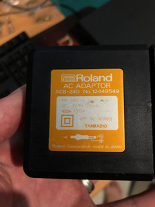

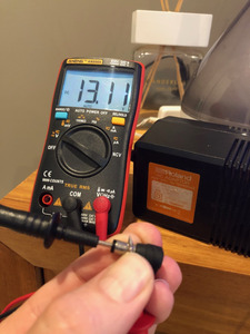

Just received a SC-55MKII. I thought it would be a good idea to test the voltage coming from the power adapter before powering on the unit. The reading from the multimeter is 13v? I thought it was supposed to be 9v. Maybe it's supposed to be 13v and then when plugged in it goes down to 9v from the circuity load.
Is anyone able to measure the voltage from their power adapter and let me know what voltage you are getting?

Reply 1 of 6, by keropi
this is an unregulated PSU, it needs load to output the rated voltage
once powering the SC-55 voltage will be fine
Reply 3 of 6, by zuldan
keropi wrote on 2024-01-30, 08:29:
Thank you so much for that information. Is it recommended to replace the original PSU (31 years old) with a Roland PSB-240A? Or are the original PSUs pretty robust? I don’t want to damage my unit with bad power.
