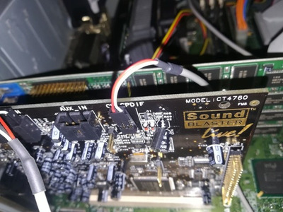

Ever since I started using SPDIF I don't think I've managed to plug the connectors right way around on the first try even once, I've looked for markings on the sound card and the drive, plugged in the cable thinking the pins are right way around, get only silence and then plug the cable the other way around on the sound card to get it working 😀
So it doesn't seem plugging it the wrong way can cause any damage. If you have a multimeter you could try to check the cable for continuity to rule out any fault on it, otherwise I guess you need to test your sound card/dvd drive/SPDIF cable separately on some other PC.
Yeah, I was thinking (and hoping!) that surely it wouldn't be so easy to plug it (even a rubbish cable) in the wrong way round if doing so can damage equipment.
How would I use a multimeter to test it? Surely the cable would need to be plugged into something to receive power?
Unfortunately, I don't think I have another PC that would support a digital cable, or have a need for one.

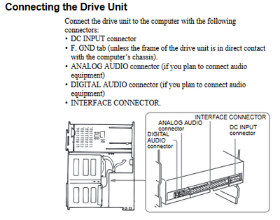

file.php?id=185197&mode=view
This text from the manual is maybe the explanation for why the digital pins seem to do nothing: The manual implies the digital pins do nothing.
Digital audio comes over the ATA bus. The headphones socket does something, as does the line out.
How to deal with that on 98? Install EAC, rip your CDs using secure mode and encode as preferred, and never worry about fragile plastic again 😀
Reply 23 of 36, by AdamP
progman.exe wrote on 2024-02-13, 10:15:
Hmm...
The manual also outright says the digital output pins do output digital audio signals. The unit documentation also implies that it does:

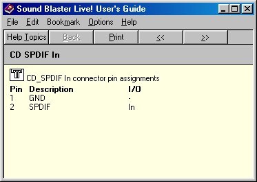

On a related note, I've checked the SBLive User Guide (help file) and it has pinouts for pretty much all connectors on the card, including CD_SPDIF:
18.47 KiB
387 views
So this confirms what I've inferred before, Pin 1 is ground while Pin 2 is the SPDIF signal.
Reply 27 of 36, by AdamP
Joseph_Joestar wrote on 2024-02-13, 19:44:
That's the opposite of what the DVD drive manual says. Does this mean it's supposed to plug into the sound card the opposite way to the DVD drive?

Reply 29 of 36, by Joseph_Joestar
AdamP wrote on 2024-02-13, 19:58:
What I posted was the pin assignment for the SBLive's CD_SPDIF connector.
The manual for your DVD drive is likely correct for its own pin assignment. Now that you know what both are, just make sure to connect ground to ground and signal to signal.

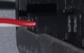

And therein lies the problem: I don't know which is which, as I have a red wire instead of a black one. If the seller is correct in that it doesn't matter which way round they go, then it seems the cable is built so that either wire can be either ground or signal. Is this normal?

AdamP wrote on 2024-02-13, 21:37:
Wire color doesn't matter. As long as the cable is functional, it will carry whatever the pin supplies.
To be clear, you can use any wire you like, as long as you connect the ground pin of the CD_SPDIF header to the ground pin of your DVD drive. Same for the signal pins.

This looks correct?
Reply 34 of 36, by Joseph_Joestar
AdamP wrote on 2024-02-13, 22:48:
This looks correct?
Yes.
