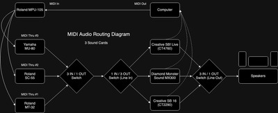

Reply 6 of 13, by epborden
Here is my audio routing diagram. Can anyone check this out and provide feedback, I'd appreciate it.
The goal is to send MIDI out from the computer to the MPU-105. The MPU-105 will then act as my MIDI thru switch selectively sending MIDI data to whichever device I need. The three MIDI devices then are, via their line out, connected to a 3-to-1 switch so I can toggle between them. From there the single output connects to a 1-to-3 switch which has line in connections to each of my 3 sound cards. This allows switchable MIDI to any sound card from any MIDI device whenever I need it.
The line out for the sound cards are connected to a 3-to-1 switch which feeds to my speakers. So I can switch between the sound cards output whenever I need it too.
Example control usage:
  1. Change the MPU-105 to output MIDI data to Roland SC-55 (MIDI thru #2)
  2. Change 3-to-1 MIDI audio out switch to position #2 (Roland SC-55 audio output)
  3. Change 1-to-3 line in switch to position #3 (SB 16 line in)
  4. Change 3-to-1 line out switch to position #3 (SB 16 line out)
  5. Play King's Quest VI (DOS) using sound output from the SB 16 and General MIDI music from the Roland SC-55
So unless I am specifically changing the MIDI device most of the switching is just lining up the input/output for each sound card depending on the game and environment (DOS vs Windows).

Reply 7 of 13, by dionb
That should work - although I'd be a bit fearful of added noise, particularly from sending the MIDI output via sound card inputs.
With this hardware it's the best you can do, what you need is a mixer/combiner. Best-case one that can simply handle all six output devices at once (tip: Behringer RX1602), but even a 2-way mixer would let you put the output of the two 3-to-1 switches and feed that into the speakers would be a big improvement.

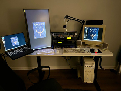

Reply 10 of 13, by epborden
250.62 KiB
374 views
Update. I scrapped all the crazy switches and my diagram from before. Took your advice and got the Behringer! What a world of difference. Everything is piped into it now and I can control things with ease. Now everything gets properly mixed no matter what audio is playing.

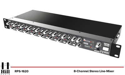

Reply 12 of 13, by megatron-uk
External mixer is absolutely the way to go - daisy-chained outputs into inputs is just a source of more cabling spiders and more noise!
Under the front edge of my desk I have one of these, mounted on a set of 1U rackmount ears:
75.56 KiB
287 views
