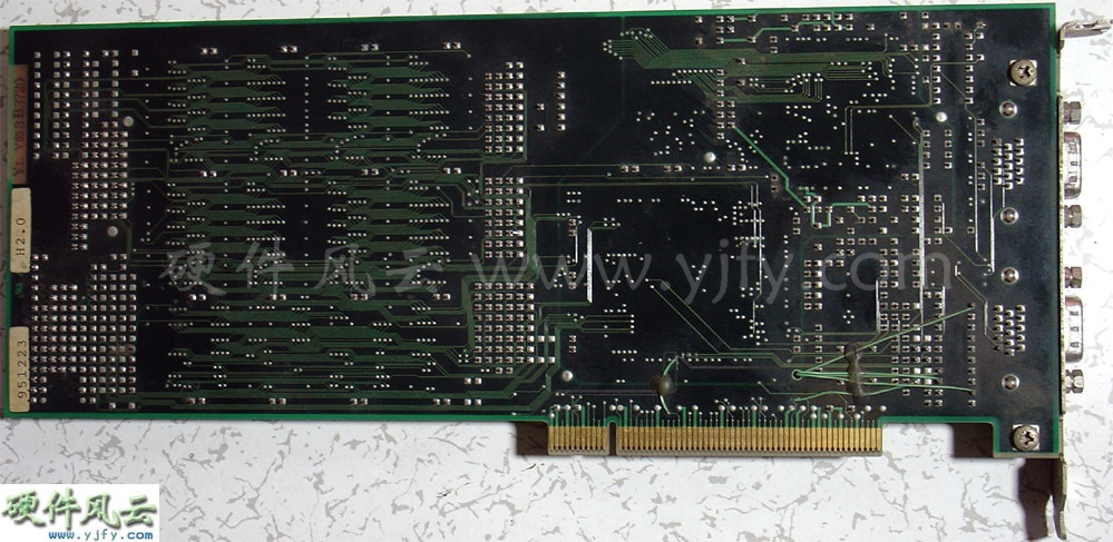

Many years ago I acquired a NOS NEC PCI-300SX/N 3D accelerator card ( https://vgamuseum.ru/gpu/3dlabs/3dlabs-glint-300sx-nec/ ). I read the manual that came with the card and saw it was only intended to work on Windows NT 3.51 running on the MIPS platform (see manual on VGAmuseum.ru). Since I didn't have such a system I just put that card away.
Today I started to do some digging and it seems the card was originally released by Densan in Japan as the PCI-300SX-A (http://www.yjfy.com/Museum/video/PCI-300SX_A.htm). The main difference I can see is that the Densan version has an extra VGA connector (boot pass-through according to their website) and is missing a small daughterboard. In the PC 3D Graphics Accelerators FAQ from the 90s it is mentioned with the following:
GLINT07) Densan PCI-300SX The PCI-300SX is a GLINT based PCI card including 4 Mbytes of VRAM framebuffer, 8 Mbytes of DRAM local […]
The PCI-300SX is a GLINT based PCI card including 4 Mbytes of VRAM framebuffer, 8 Mbytes of DRAM localbuffer, 64-bit IBM RGB525 RAMDAC and VGA pass thru implementation. Optimized drivers are provided for Windows NT 3.5 and OpenGL.
The Densan PCI-300SX now shipping as part of NEC RISCstation 2200.
For more detailed information, please contact:
Tetsuya Kawamoto or Zhang Yuanli
Tel: +81 3 3329 3871
Fax: +81 3 3329 9266
5-42-1, Kamikitazawa Setagaya-Ku, Tokyo, Japan
I managed to find their product website from 1997 and on it there are drivers for Windows NT 4.0 and Windows 95 for the Intel plattform (x86). I cannot find those files anywhere else online, but the filenames look very similar to the generic 3DLabs Glint driver files and the general version names (2.7 and 2.9 for Windows NT 4.0) also matches.
This got me thinking that the NEC PCI-300SX/N might actually work on the x86 platform even though it was released for MIPS. Do anyone have any extra light to shine on this? I thought it would be good to ask before open up the card and break the seal.
I also have the original driver floppy discs with the MIPS WinNT 3.51 driver and the OpenGL techdemos mentioned in the manual. I'll post images of these to vogonsdrivers.
