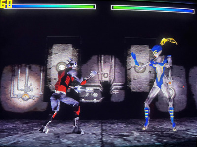

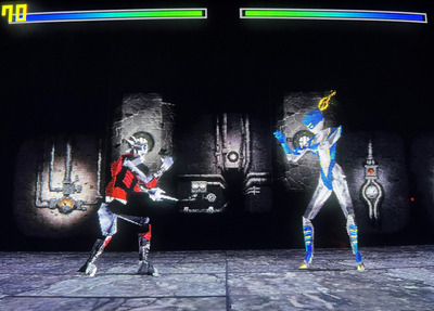

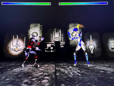

The game definitely supports hardware acceleration, though. I took three screen shots running on a 3dfx Voodoo Graphics (No 3dfx spinning logo popped up), QDI Rendition V2200 8MB AGP (Voodoo DirectX support was disabled and monitor cable moved to the Rendition), and Software (DirectX completely disabled). It looks like bilinear filtering is applied when hardware acceleration is available, maybe additional shading?
Perhaps someone has a 3dfx (and even Rendition???) patch I can try out? Unless I'm missing something, which is possible, this game can be removed from 'Glide only' consideration.
EDIT - I added 2 more screenshots from a Windows 2000 virtual machine in VMWare Workstation 16.x. I'm sorry the software version is blurry (1st photo), but it's going crazy with the CPU speed. In any case, you can see in both shots the hardware version has filtering and shading (2nd photo).

Seems that it only uses Direct3D for 3D hardware acceleration and nothing more. And yes, I also found a YouTube video where someone allegedly ran it on "3dfx mode" with nGlide.
The way how it sounds is similar to Forsaken which also has several "modes", but it only used Direct3D for these except the software renderer.

The game autodetects a hardware.
The game uses winglide1x. Glide.dll + sst1init.dll. This API is PitA on a real hardware (V1 or V2 only, not works with the hub architectire, not detects Voodoos on a fact fast CPU etc). But there are nGlide and glide1x->2x wrapper from kjliew.
There is the 3dfx logo (if you copy 3dfxspl2.dll to 3dfxspl.dll) if you run this game with nGlide. I can test WinXPSP3 + Voodoo2 SLI + glide1x->2x wrapper but later (no ddraw/d3d for Voodoo2 in WinXP so no video after I unpug the Voodoo link = the game uses the glide API).
P.S. A Rendition card as the supported hardware? I doubt this. No "VL_CloseVerite_" etc in cyper.exe cyber.exe dump...
P.S.S. The game is too fast in WinXP but there is the (partial?) fix.
Cyber.exe:
Offset 3116 replace C4 FF FF FF to 0E 30 04 00.
Offset 3125 replace B5 FF FF FF to FF 2F 04 00.

Great, thanks for the details!
The rendition was probably mentioned in the readme file because it was also available out in the wild at the time.
On original hardware using an original Voodoo on a Pentium II 400, CyberGLadiators ran OK (via Direct3D), but it didn't look any different (besides Gamma) than when it was running on the Rendition Vertite V200 with acceleration available. Is there are visual difference when running with Glide?
In any event, it is being accelerated with Direct3D if Glide isn't available. In another test enviroment using a Virtual Machine without nGLide, no 3dfx files of any kind, Direct X9.0c on Windows 2000 SP4 w/Windows 95 compatibility layer enabled for the shortcut, only when I disabled Direct3D did the game use Software mode (and DirectX can be completely disabled for that matter).
If you run the game in software mode, at the fighter selection screen, you'll notice when Direct3D is disabled the game assumes hardware is weak and defaults to interlaced graphics: it doesn't do this when Direct3D is enabled, you can't dynamically adjust the resolution with the +/- keys when Direct3D is active, and there is no shading or filtering (as shown in previous photos).
As you say it can use Glide (thanks for informing me!), but it also uses Direct3D, meaning, from my testing, GyberGladiators can be confirmed of using Direct3D for acceleration and removed from consideration from Glide only.
I wonder why this game is not listed as nGlide compatible for Glide native? It must have been missed and should be added, if so.
https://www.zeus-software.com/downloads/nglide/compatibility
Meatball wrote on 2022-12-14, 15:07:As you say it can use Glide (thanks for informing me!), but it also uses Direct3D, meaning, from my testing, GyberGladiators can be confirmed of using Direct3D for acceleration and removed from consideration from Glide only.
The game not starts on my retroPC in the d3d mode. Cyber.exe is listed in the task manager but does nothing. So CyberGladiators was software/glide in my list.
Tnx for the info.
P.S. There is the "-m -3 -g -w -d -s -p -v -f -f i" string in cyber.exe dump. Run keys? Let's test...
P.S.S. "-w" runs the game in the window mode. Without d3d disabling. And with glide.dll.
"-d" forces the fullscreen software mode.
"-3" looks like d3d forcing (can't test).
"-f" starts a 2P game w/o the main menu. What for?
