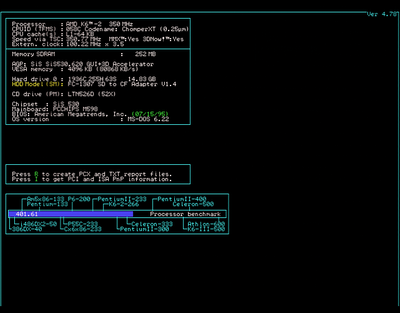

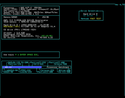

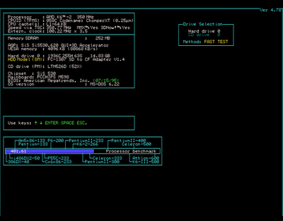

That H Shift on the Extron has exactly the same effect as the shift in VCS, doesnt make a difference. And of course it then moves the other side out of screen.
In fact that "missing pixel" is actually introduced by the Extron as it seems like it just slightly changes the phase.
So without the Extron you can have it centered. With the Extron you either have the left border out of screen, the right border out of screen (if you use horizontal adjust on VCS or the Hardware). The only way to get it centered is to change the phase shift and make it look unsharp, or to increase the resolution to 642x480 (because 641x480 doesnt work in VCS) via an alias. So in theory I guess you could also use 642x480 and then "downscale" it to 480...didnt test that. But it would also add one additional step, and no matter what I would need the 800 screen size which doesnt change automatically.
The Hotkey function also doesnt work for me. With 2 settings saved, none of them active, both set to hotkey activation (CTRL+F1, CTRL+F2), it never switches. Hotkey just doesnt work, using it version 2.6.0 on Windows.
For testing speedsys is great as it has this bars on either side.
Without the Extron:
58.88 KiB
731 views
With the Extron:
87.94 KiB
731 views
With the Extron changed width to 797
85.79 KiB
731 views
You can see that only the first one actually has a complete pic in good quality.
