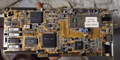

theelf wrote on 2022-12-03, 01:39:
Hi! im looking for help, looking dos/win31 drivers for this card
thanks
I think it might be one of these
https://www.clubedohardware.com.br/forums/top … hipset-mvp131a/
whose driver might be
https://www.driverguide.com/driver/detail.php?driverid=28998
mpegpro.zip
998 KiB
53 downloads
EXDT: Looks like I am likely wrong.

Hi, thanks for info! sadly i cant test, the install is not working since two files are corrupt
