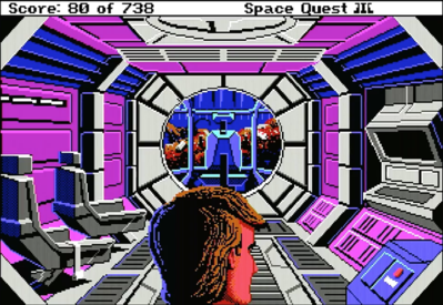

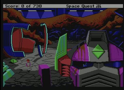

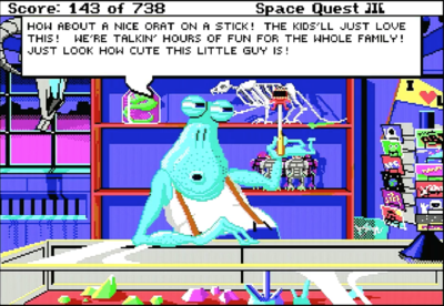

I finally got a sufficiently good setup that satisfies my needs. The hardware setup:
* OSSC 1.6
* Generic USB 3.0 HDMI capture card
* Suntac 80286 board @12MHz with 1MiB of RAM, 1 GiB CompactFlash
* DIY AdLib clone
* Trident TVGA 9000 with 512KiB of RAM
The VGA and the AdLib are going into the OSSC AV3 inputs. The OSSC has been flashed to 0.81 firmware. I still needed to adjust the advanced timings, until the whole screen was visible. An auto adjust feature would be really nice here... 😉
I made a YouTube video about this setup as well, capturing a play session of SpaceQuest 3. I will make a more detailed video about my setup using the OSSC some other day.
Links:
OSSC: https://www.videogameperfection.com/products/ … urce-converter/
USB HDMI: https://www.ebay.de/itm/HD-HDMI-zu-USB- ... 2592248871
YouTube video: https://youtu.be/vY_ervrTTAM
Here are some still images grabbed from the video, so there are compression artifacts. I still need to tweak the capture setup a bit and try to get non-lossy grabs as well. Not sure if the capture card supports those. But for streaming and YouTube the setup is quite nice.
194.28 KiB
2495 views
334.05 KiB
2495 views
414.04 KiB
2495 views

Reply 512 of 1112, by elianda
Also the black background appears grey and white, like the menu bar in SQ3 is grey. These are not compression artefacts.
Youtube Channel
Reply 513 of 1112, by root42
Yes, the dynamic range is sub optimal. I think this is due to the VGA card. Currently I am capturing with default settings. I might play around with color settings later. I did turn OBS to automatically determine color space, but then the blacks in the OSSC test image will be crushed. But again: I am capturing from a 28 year old cheap TVGA card, so I do not expect the best image quality to begin with...
Maybe with some careful adjustments I can get the black to be darker and the white to be brighter. The colors are also a little bit washed out, so there is some room for improvement as well.

Reply 514 of 1112, by NJRoadfan
Looking at the image, both horizontal sampling rate and sampling phase need to be tweaked. Don't rely on the OSSC test image for accuracy when calibrating the levels on the capture card, use a test pattern from your source. Its very likely the capture card is needlessly converting the input video's color space to 4:2:2 YUV from 4:4:4 RGB, which is going to screw up blacks anyway.
Reply 515 of 1112, by root42
Oh yeah, I had to completely tweak the advanced timing parameters. It would show only a fraction of the image before. I am open to hints and suggestions! But I am already very happy with the results I am getting. It is so much better than my 10 EUR converter I had before. 😉

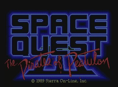

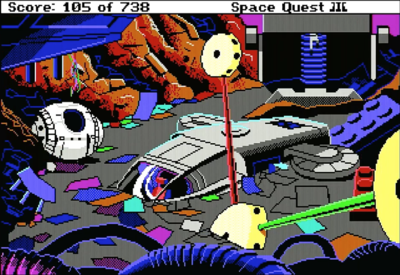

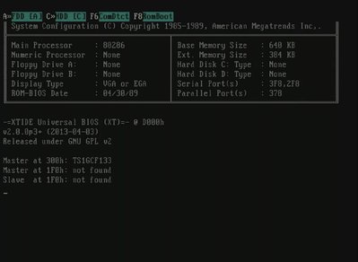

Reply 518 of 1112, by root42
I have tweaked the OBS settings (not so much the OSSC, apart from disabling scan lines) and now the image is much better. I ramped up brightness and contrast, which led to a much better picture. SQ3 is not looking pretty good. 640x480 60 Hz games still have a bit missing at the top, e.g. Eric the Unready. Even though the 0.81 firmware has a preset for this. So I need to dig deeper into this. Maybe my Trident VGA card is a bit wonky. Are there any resistors or caps that could be bad and influence this? Or is this all down to the RAMDAC and/or the TVGA IC?
784.84 KiB
2375 views
852.16 KiB
2375 views
659.22 KiB
2375 views
Video Footage of me playing SQ3 with improved picture:
https://www.youtube.com/watch?v=GqGWSDM4FfY
