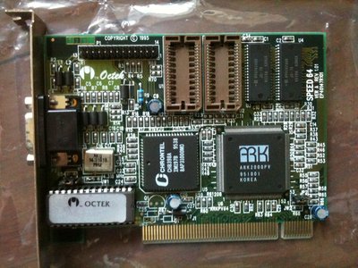

just got this card, will be running it through it's paces later today along with a ATi Mach64 Wincharger & Matrox Mystique 220 4MB.
