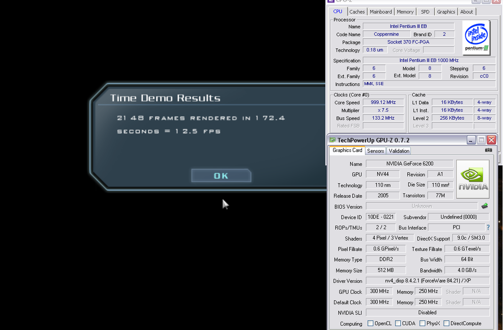

By the way, here is a Compaq Deskpro EN from the year 2000 very upgraded with a GeForce 6200 512mb of VRAM (PCI version, no AGP on this baby), 512MB of ram (max the chipset allows), a 1Ghz Coppermine Pentium III, a 160GB SATA hard drive through a SATA\PCI controller card and a USB2.0/PCI controller card.
p3%20doom3_zpsu8cwbcvt.png~original
Seems that Coppermine CPUs aren't very good with Doom3 aren't they? Yes i know that the PCI bus doesn't help either but still...

Reply 356 of 648, by Standard Def Steve
I think you're actually being limited by your video card there. My 64-bit FX5200 AGP can only do 6.5 fps, and that's with a 2.64GHz Athlon64 behind it! 12.5fps for 64-bit GF6200 PCI is quite good!
