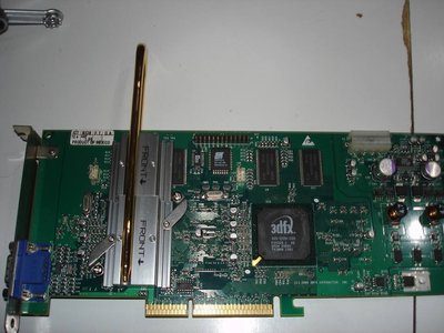

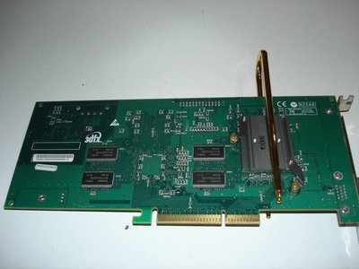

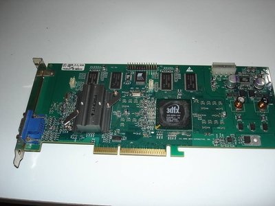

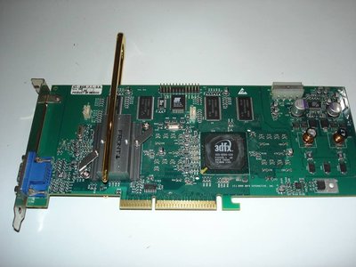

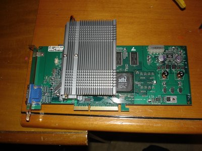

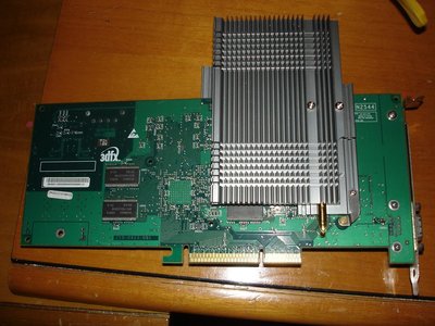

Reply 20 of 23, by amijim
Here is a fanless solution for our voodoo 5500.Stay tuned.

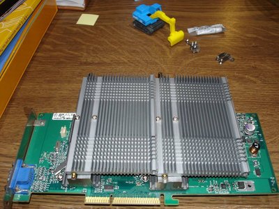

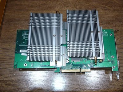

Reply 21 of 23, by amijim
The voodoo5500 will look like this.I am waiting for my friend Costas to bring me the second heatsink.It is a zalman zm80c-hp bought new locally 7euros each.

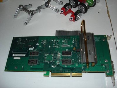

Reply 23 of 23, by amijim
The mod physically is okey but i have to deal with the weight.It seems that the pcb bents on the weight of the heatsinks.I will complete the mod ,run some tests and remove parts of the heatsinks and i will report back.Stay tuned.
