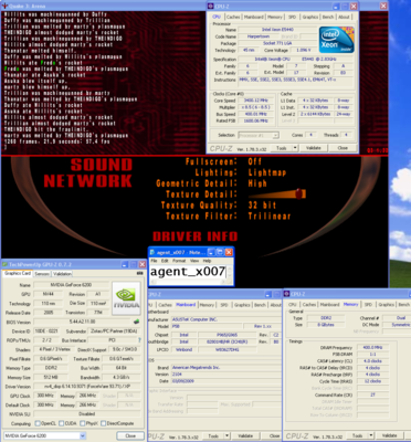

Reply 5 of 13, by nforce4max
Only get the 6200 if compatibility is not a concern, the 9250 is a decent choice given the 5500's weaknesses generation wise. If you want to be posh and have Glide either go with a Voodoo 2 setup which has become ridiculous price wise or try to get lucky finding a Voodoo 3 pci though preferably without having to throw the kicking sink at it (expensive).

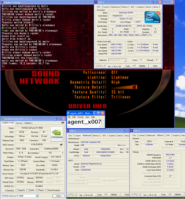

Reply 6 of 13, by agent_x007
"Weakness" ?
Radeon 9250 is DX8.x only.
I'm pretty sure FX 5500 with 128-bit DDR memory bus will anihilate Radeon 9250 64-bit (in any game).

I'm not saying FX is great design by any stretch.
BUT I just think 128-bit vs. 64-bit can give it the edge in old games.
