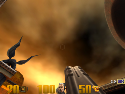

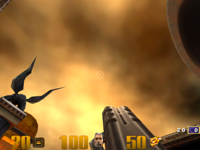

PhilsComputerLab wrote:
To my eyes these look nicer than the screenshots posted?
Not really. Blocky pattern is still there:
Are we looking at the same screenshots?
This is the one you supplied, which looks horrible. I'm not getting anything even close to that, so not sure what's going on. When did you create your screenshots and what driver and settings did you use? Would be good supplying those to avoid stumbling in the dark?

Reply 21 of 123, by The Serpent Rider
I've posted only 1600x1200 screenshots on Q3DM5. Without texture compression.
They were made around 2-3 years ago.
You'll get the same result on any GeForce 1-7 and any driver.
Settings are identical to your screenshot.

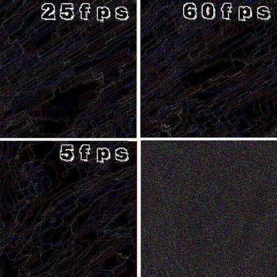

I'm with Phil on this one. No block pattern in any of Phil's screen shots. However there seems to be some consistent banding in yours? How do you capture these images? They show decoding artifacts?
Phils screen shots (both sizes) show no banding what so ever for the sky texture.
Interpretation of vision (eyes) can lie, numbers (image data) don't 😀
Open image in Gimp...
Filter -> Edge-Detection -> Edge -> Set Amount to 10.0 -> Select 'Laplace'
342.35 KiB
2114 views
Clockwise from top left: Kyro, GeForce, Phil's, Voodooh
Black regions denote banding, for no banding it should be noise (like Phils images, 1600x1200 and the smaller one). Black region denotes no difference across adjacent pixels (a loss of precision when representing the gradient colour change across that region). Full noise implies each pixel has distinct difference, no patches/regions with the same colour when rendered.

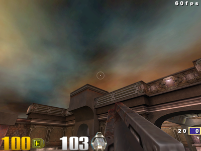

Reply 31 of 123, by PhilsComputerLab
DVI capture of Quadro2 Pro 1600x1200 attached.
YouTube, Facebook, Website
Reply 32 of 123, by PhilsComputerLab
And another one with a dark cloud?

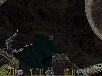

Reply 33 of 123, by The Serpent Rider
Pretty much same thing:
462.46 KiB
2029 views
Looks like Quadro series are plagued as well.
Reply 34 of 123, by PhilsComputerLab
I've got your two screenshots open, as well the one I took, and yours (V4 and GeForce) looks noticeably worse than the one I supplied. The banding in yours really stand out and your images appear blockier also. What are your thoughts? Can you see the banding difference?
Could be the way you took the screenshot, this can often be a common issue with screenshots not fully showing what comes out of the graphics card.
Reply 35 of 123, by The Serpent Rider
Another map, different sky texture. Q3DM5 please.
Pattern didn't change though - color transitions are still blocky.

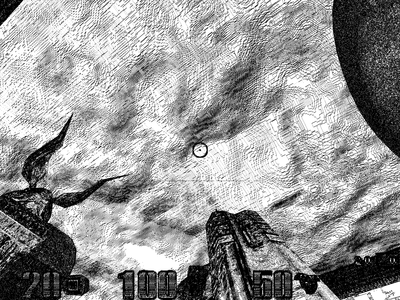

Reply 39 of 123, by spiroyster
The Serpent Rider wrote:
spiroyster wrote:
While the renderer may have used uncompressed textures, when you saved the resultant-screen shot/frame-grab, you then saved the image in jpg and not at 100% quality, ergo it saved it in a lossy format (reduced quality for compression) and this is the banding issues seen in your images, not bad IQ from any GeForce 1-7.
That's not an issue.
This PNG is the JPG you posted earlier simply saved as a PNG?
It doesn't work like that unfortunately. Saving a 2/3 year old JPG which has already had lossy compression applied as a PNG doesn't bring back all the discarded data from the original encoding. o.0
@Phil
Massive tear! 😀
