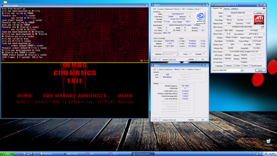

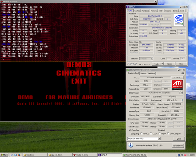

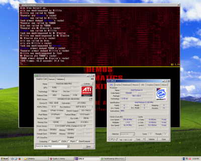

Reply 144 of 203, by Standard Def Steve
I'm now running my PIII at 1628MHz, so I thought I'd retest my 9800 Pro. My previous score @ 1575MHz was 208.6 FPS.
PIII-S @ 1628MHz, 155MHz FSB
2GB DDR @ 310MHz, 2-2-2-5
9800 Pro @ stock, Catalyst 4.12
X-Fi Platinum
QDI Advance 12T mobo, Via Apollo Pro266T chipset
WinXP Media Center 2005 SP3
1024x768, all settings maxed = 220.2 FPS
1.81 MiB
2586 views
This machine is now EXACTLY twice as fast as a PIII-850.
598.33 KiB
2586 views
And 7 times faster than a P2-300!
894.39 KiB
2586 views

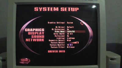

Reply 145 of 203, by athlon-power
Now that I've got a graphics card that will perform acceptably, I'll go ahead and post my results here. Specs of the system are:
- Intel SE440BX-2 Motherboard
- Intel Pentium III Katmai 500MHz SL35E
- Single-stick 128MB PC133 RAM under-clocked by the motherboard to 100MHz.
- Creative Labs 3D Blaster 32MB (nVidia TNT2 32MB, 125MHz core, 150MHz memory, 128-bit memory bus)
- Cobra AW744L-II PCI (Yamaha YMF744)
- Samsung SC-148F 48x IDE CD-ROM
- Western Digital WD400 40GB IDE HDD
- 3Com EtherLink XL 3C905C-TX 10/100 PCI
- Mitsumi 1.44MB 3.5" Floppy Diskette Drive
I got 24.5 FPS.
When my system was using the 16MB TNT2 Pro I had (143MHz core, 166MHz memory, 128-bit memory bus), I got a whopping 9.8FPS average. I'm unsure as to why this is- the only edge that my current TNT2 has over my old TNT2 Pro is that it has 32MB of VRAM. I guess Quake III favors cards with more VRAM, I'm not sure.
755.34 KiB
2516 views
717.45 KiB
2516 views
Also, I noticed the extreme differences between the other systems used in the first post as compared to mine. Some people were getting ~38FPS average with a Pentium II 350! All of those systems had a 3DFX Voodoo of some kind in them, most of them used Voodoo 3 cards. I guess that's the power of Glide.
Where am I?

Reply 148 of 203, by athlon-power
havli wrote:
The requirements are: 1. demo001 2. 1024x768 resolution (windowed mode also allowed) 3. 32-bit colors and textures (except Voodo […]
1. demo001
3. 32-bit colors and textures (except Voodoo3 and possibly other 16-bit only capable HW), Lightmap lighting and full details
Garrett W wrote:
You are using 32bit color depth which probably kills performance on the poor TNT2. Pull it back to 16bit and performance will see a huge boost.
That's the official requirements of the benchmark, though- completely maxed out settings, save for the resolution. There's no way I'd ever actually run the game at these settings, it would probably be too slow, I just use the High Quality preset (even though I think that uses 32 bit color as well), and it's more than playable. I'll probably run it at the same settings, save for setting the color to 16-bit, when I get home later today, and see what results I get from that.

Reply 154 of 203, by 65C02
Standard Def Steve wrote:
I'm now running my PIII at 1628MHz, so I thought I'd retest my 9800 Pro. My previous score @ 1575MHz was 208.6 FPS. […]
X-Fi Platinum
Radeon 9800 is a pretty new card for the Pentium II/III. The video driver is probably leveraging the SSE instructions on the PIIIs making them much more efficient than the P2. As I recall, the PII wasn't much slower than PIII when SSE instructions weren't being used.
Running the timedemo on my Celeron 466 with GeForce 4MX-440 nets approximately 45 FPS. It's not great, but I would have been happy with it 20 years ago. 😊

Reply 158 of 203, by rcarkk
Just to confirm the settings. Should we use the absolute maximum settings and 32bit colors except trilinear filtering? Or should we use high quality preset settings without trilinear filtering?
