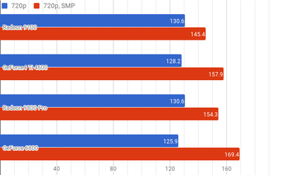

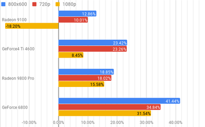

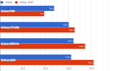

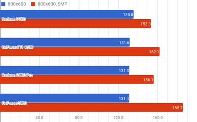

Here are the new results I was working on. The specs of my system are the following;
2x P3-S 1400
OR840 motherboard (i840)
Audigy2 Zs
Promise SATA300 TX2 controller, 2 SSDs plugged in.
Windows XP Pro, SP3
ForceWare 93.71 / Catalyst 5.8, settings left to default
These pertain to q3a 1.32c, all options maxed out. I test 4 different cards with 3 different resolutions: 800x600, 1280x720 (720p), and 1920x1080 (1080p). I chose 800x600 as reference—all cards can max this out—and the other 2 because they are modern resolutions that I would want to use, and because the step between all 3 resolutions more or less doubles the number of pixels that needs to be pumped. For 800x600 the FOV is 90, for the other resolutions the FOV is 106.

1080 gave the Radeon 9100 a hard time. When testing with SMP, the first run gave ~90 FPS, the next 4 runs gave ~75 FPS. I did this at least 3 times and it always happened like this.
