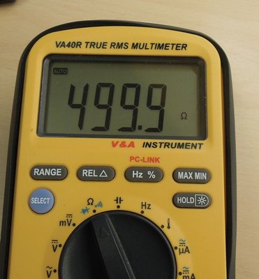

Reply 108 of 341, by retrocanada76
can you measure the resistance from each color pin ? From keropi pictures the problem seems to be on B3,G3,B3 they seem to be too bright. These pins should be 500 Ohms each.
B3,R3,G3: 500 ohms
B2,R2,G2: 1K
B1,R1,G1: 2K
B0,R0,G0: 4K
Reply 109 of 341, by dreamblaster
on mine it all seems close enough
86.08 KiB
1023 views
Thanks for your support !
Reply 111 of 341, by retrocanada76
Dreamblaster, did you try another monitor / tv ? just for the sake. If the voltages are correct there is nothing wrong with the unit.
Use the last FW, and show the colorbars using a different monitor/TV.
Reply 113 of 341, by keropi
retrocanada76 wrote:
can you measure the resistance from each color pin ? From keropi pictures the problem seems to be on B3,G3,B3 they seem to be to […]
B3,R3,G3: 500 ohms
B2,R2,G2: 1K
B1,R1,G1: 2K
B0,R0,G0: 4K
All these check out on my board as well.
Tried latest fw and also a completely different lcd screen, did not help. I will try again once I have installed the 1% resistor networks.
Reply 114 of 341, by retrocanada76
Sorry, It can't be the resistors. It makes no sense! If your values are correct, them there is no need to replace them. Just do a sanity check and make sure they are not shorted. Specially cross-color, like Bx is not shorting any of the Rx, Gx and remaining Bx's.
It would be wise to take a look on the shift level 74LVC245 as well as the voltages sent from your board. What is the EGA card are you using ?
Do you have another EGA card ? What if you jumper it to CGA display ? Does the text color color bar change ?
