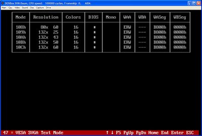

1.a. If VESA text modes are supported then you get something like this in FWIZARD:
223.68 KiB
5964 views
1.b. And something like this in AIDA 'Graphics -> SVGA VESA Text Mode' section:

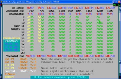

2.a. If VESA text modes are not supported then you get something like this in FWIZARD (as I said green means not supported):
230.31 KiB
5964 views

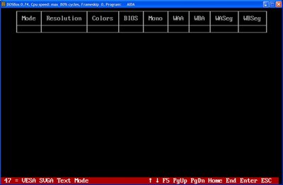

2.b. And in AIDA:
54.63 KiB
5964 views
In case of both Geforce 6600 GT and Geforce Kepler/Maxwell you get something like the 2. case: VESA Text modes are not supported at all.

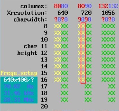

But yes, Geforce 6600 GT and Geforce Kepler/Maxwell are different in the way that 720x400/90x25 non-stanard VGA mode is supported by Geforce 6600 but not by Geforce Kepler/Maxwell.
But this mode is not a standard VGA Text mode so the support is not 'demanded' by VGA standard:
https://en.wikipedia.org/wiki/VGA-compatible_ … mmon_text_modes
The bug is triggered on Geforce Kepler/Maxwell when you select any modes represented by the 4th yellow 'X' column in FWIZARD.
I mean these ones:
60.03 KiB
5964 views
