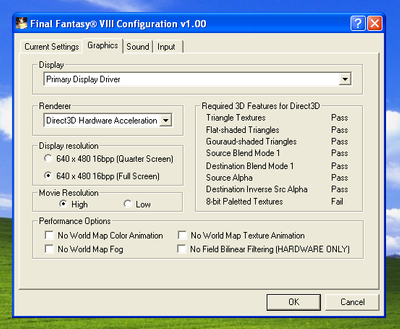

My Matrox G400 just arrived and I got the GeForce6 as well, so it's time for another round of testing. Once again this was my test system. However, the G400 refused to boot in that computer, so I had to test it using my Celeron rig. All tests were performed under Windows 98SE with DirectX 9.0c. No unofficial service packs or any third-party hacks were used.
Graphics cards tested:
  • Nvidia GeForce2 MX400 using Nvidia reference drivers v77.72
  • Nvidia GeForce6 6200 using Nvidia reference drivers v77.72
  • Matrox G400 using Matrox Powerdesk drivers v5.52.015
Note: for the purposes of this test, I will be using the same driver version for both Nvidia cards. This was done to take any driver related issues out of the equasion. As always, all driver settings are left at their default values.
Games tested:
  • Final Fantasy VIII Demo - you can download the free demo from here
  • Thief II: The Metal Age - retail CD version with the latest official patch 1.18 applied

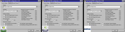

Final Fantasy VIII configuration program
169.31 KiB
1258 views
The config tool detects paletted texture support on the GeForce2 but doesn't find it on the GeForce6, nor on the Matrox card. Fortunately, FF8 still allows all cards to run the game in 3D accelerated mode.

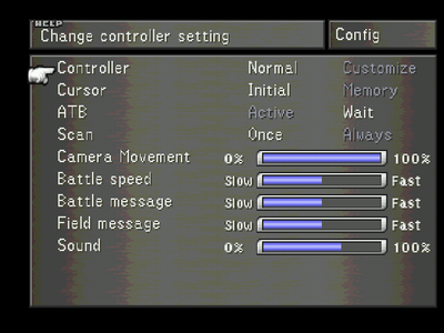

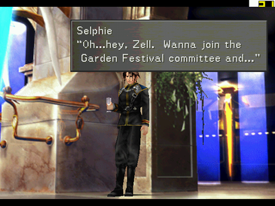

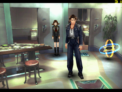

Final Fantasy VIII options menu
237.57 KiB
1258 views
To access this screen, start a new game, then press "D" to open the menu, move the cursor to "Config" using the arrow keys, and finally press "X" to open it. Since both the GeForce6 and the Matrox G400 show the washed out menu colors (same as the ATi card previously) we can conclude that this is indeed caused by lack of paletted texture support on those cards. The menu colors are rendered correctly on the GeForce2, and since it uses the same drivers as the GeForce6 for this test, we can narrow it down even further to paletted textures.

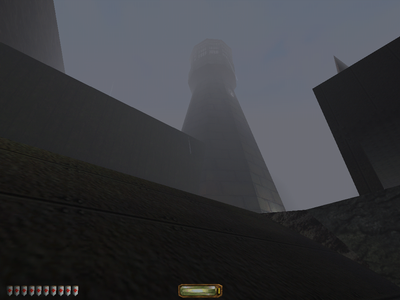

Thief II Mission 11: Precious Cargo
124.34 KiB
1258 views
As expected, table fog works fine on all of these cards. The GeForce6 series still supports it, and the Matrox G400 spec sheet states that it supports table fog in hardware. As you can see from the screenshots, the Matrox and GeForce6 cards render fog the same way as the GeForce2.
In summary, table fog support is functional on all three cards. And Final Fantasy 8 seems to be the definitive test for paletted texture support, since it checks for that feature in the config and also shows a visible difference when it's missing. If you want to test your own cards, feel free to download the FF8 demo linked above and try this for yourself.

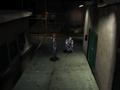

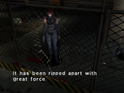

During my tests, I have found that some rendering issues unrelated to paletted textures and table fog may occur in certain games. Some examples:
Dino Crisis - fence
193.29 KiB
1231 views
As before, both GeForce cards are using the same drivers here (v77.72) at their default settings, but somehow they produce very different results. This screenshot was made with filtering turned on in the Dino Crisis config menu. While turning this off fixes the fence rendering on the GeForce2, it doesn't change anything for the GeForce6. Matrox renders the scene correctly, regardless of whether filtering is turned on or off.

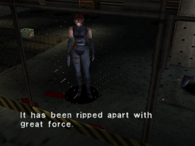

Dino Crisis - floor
202.57 KiB
1231 views
Notice the floor tiles with the debris on them. The GeForce2 and Matrox card render them correctly, while the GeForce6 has heavy distortions. Again, both GeForce cards use the same driver version here and turning filtering on/off doesn't change anything for the GeForce6.

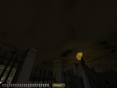

Thief II Mission 1: Running Interference
107.64 KiB
1231 views
Both GeForce cards fail to render the stars in the night sky of the first Thief 2 mission. Matrox renders the stars correctly.

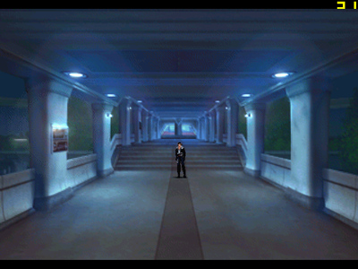

Guys, after some search i found that ATI X1900 will be the most powerful and most compatible card for old games, basically while geforce 6 was a trash card for retro games, ATI kept it all working up until dx10 card showed up. Thief is displayed perfectly here, with fog and stars. Also some 8-bit Paletted Textures games worked like charm. Any recommendations on further tests, maybe some tough games?

Are you using Windows 2000 or XP? As mentioned before, ATi cards will render proper table fog on those operating systems when drivers 7.11 or higher are used. But under Win98, you can only get the fog using tweaks, which doesn't look the same.
Yes, i'm using Win XP here and driver 9xx or smth like this. There are Windows games that use palette textures and don't work properly under XP?
Which games?
I've got a complex answer for this. I was looking for most compatible laptop some time ago and bought Toshiba with Geforce 6600. This was trash. Any game in 16bit looked like trash (GTA 2, Deus Ex in 16bit, Thief II and so on. I've also checked this list https://nvworld.ru/faq/geforce-6800-game-limitations/ and Shadow Vault wasn't working on NV 6600.
But it's all working like charm on ATI X1400, X1600, X1800 and X1900. Yes, on Windows XP.
So I've made a conclusion that old games stopped properly working on geforce 6 and ati kept it's compatibility with old stuff up util their first DX10 videocards came up.

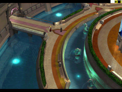

Tried FFVIII, no idea how it should look. But from my point of view it's okay. What do you think?
In config menu I've got 8-bit error.
59.51 KiB
958 views

Same as my Radeon 9000 then. Can you do a screenshot of the options menu as per my instructions above? I'm curious about the menu bar rendering under WinXP.
228.16 KiB
912 views
And no fog screenshot. I've got wrong driver and fog is not working, i'll install smth newer and be back. It's 100% working on ATI, just some driver issue.
45.1 KiB
912 views
Looks like menu is dirty, i've compared with other screenshots.

Yeah, the washed out background colors in the menu are the result of missing paletted texture support. Just like on my own ATi card, my Matrox G400 and the GeForce6. Thanks for confirming that it also occurs on ATi cards running under WinXP.

I've installed Catalyst 10.2. I'll try 7.xx driver but it can be tricky since it's a laptop card and such old driver maybe won't work even with modding.
I don't understand. If FFVIII has dirty interface it means card is not displaying 8-bit palette colors properly, right? But Thief works perfectly. And other games from my list on nvworld.ru work perfectly.
