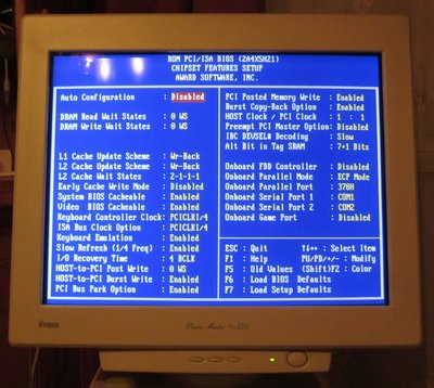

Got a 22" CRT and after connecting it to a 486 and starting up Doom I thought the monitor/cable/connector was faulty as the picture was practically "wholesale" purple.
By accident I got Win95 started and surprise... everything looks ok there.
Is this due to a fault or common behavior for larger screens? Similar thing can be observed on the 21" SUN I have.

Reply 2 of 6, by amadeus777999
Ok, I'll look into that.
The previous owner said something about a bad cable which meant he noticed something off and only took the simplest solution into account.
The strange thing is that in the bios screen it's looking normal and in Windows when one changes the individual channels the green one is as responsive as all the others... cranked up it "greens" away which shouldn't be possible if the gun or another component is faulty.

Reply 3 of 6, by Jo22
Perhaps it is somehting else then.
The green channel uses pin 2, which is also used for monochrome video (source).
If the monitor was not correctly recognized by the VGA card through DDC or Monitor ID bits, strange things couldn happen.
Maybe the monitor receives no signal or a grayscale signal over the green channel (pin 2).
This would make sense insofar, that your issue vanishes once an application (Win95) is in control (overwrites VGA BIOS settings).
I know, this pretty far-fetched. It's just an idea, anyway. 😅
Maybe it helps to disable "VGA palette snooping". It also caused funny things in the past.
Like an messed-up colouring of the Win95 boot animation.
Reply 4 of 6, by amadeus777999

This sounds like a pretty good tip.
In Doom, for example, everything's SanFrancisco'd but once you pick up the hazard suit(green palette) it looks normal.

Ok, I retested this with the "palette snoop" feature toggle'd and it does not make a difference - the Matrox seems to exhibit this issue in DOS nonetheless. I tried an Ark1000 and this one is way better... the love-tint is gone from the DOS prompt and in-game the picture exhibits way better color temperature.
BUT I still feel that the overall hue is off. One can only regulate red and blue values but not the green one.
Could the "green gun" be weak/the tube in general be worn out?(excuse my meager knowledge of how CRTs work) If so is it realistic to find a replacement or is this typical of an enthusiast's "somehow possible solution".
@CHIPS: I'm running the CRT with a standard vga cable but already ordered a component one and will report my findings.
Update:
it seems that the monitor just exhibits this kind of reproduction in DOS - no matter how high the resolution.
The picture is rather dim and lacks green - when in Windows the picture is pretty good and normal looking which disqualifies the option of a real technical problem most likely.
I put the screen into a closet and will test it later when I have the VGA/BNC cable. Put out the SUN/Sony and its picture is WAY better no matter if DOS or Windows.
