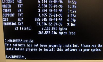

I believe I tried that already. The files extracted, but it also says that it is not configured properly and to run the installation. So, not sure what I am doing wrong.
Reply 22 of 29, by feipoa
Here is the error in DOS when I try to run univbe.exe from univbe52.
171.51 KiB
1196 views

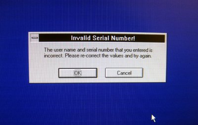

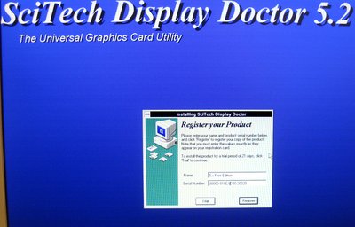

Here is attempting the free released registration code in Windows 3.11 with univbe52.
578.95 KiB
1196 views
Here is Univbe telling me my registration code is wrong.
170.04 KiB
1196 views

Brief update... Figured out Univbe 5.2. Univbe 5.3 and Univbe 5.2 use the same registration file, IO.IDX in C:\ , and for some reason Univbe 5.2 installation won't override 5.3's IO.IDX file. You need to delete the 5.3's hidden io.idx file, then install Univbe 5.2. To use univbe 5.3 again, you need to put the old io.idx file back in c:\. The only benefit I could see from 5.2 over 5.3 was that it uses 12 KB of conventional memory as opposed to 13 KB. Both versions have VESA 2.0 support.
