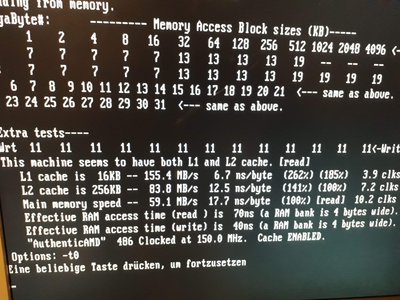

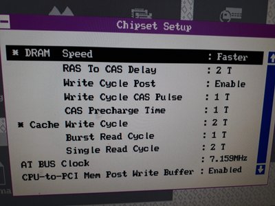

In the past, I had tested the Am5x86-150 with 1024K/128M, however with 256K/64M, I was able to get the system stable with a cache wait state of only 3-1-1-1. It would be fun to test the system with 10 ns cache (counterfeit) or 12 ns cache (real) to see if the wait states could be reduced to 2-1-1-1. Because of wait states, the L2 speed of the Am5x86-150 was the same as the Am5x86-160. The Am5x86-160 still has the benefit of the 40 MHz PCI bus, while the Am5x86-150 is running at 33 MHz. The resultant is that the Am5x86-160 is about 4% faster than the Am5x86-150.
I've got these settings stable on an Am5x86 @ 150 Mhz with real 12 ns cache. Only DRAM setting couldn't be maxed out, haven't tried with a 50ns stick though.
This is on an Acer AP43 with 256k dual banked. Stable means DOS, DOOM and Quake stable. No Windows testing.

155/84/46 for 2-1-1-1, and I assume that "DRAM Faster" = 1ws/0ws?
I get 155/76/56 for 3-1-1-1 and DRAM 0ws/0ws. Data on page 4 of this thread.
Did your system pass HIMEM with these settings? Will you be able to install Windows and run a game? It is fairly easy to get faster settings going in DOS.
Are you also using 12 ns for the TAG?
I might have some real 12 ns cache coming. At which time, I intend to try 10 ns fake, 12 ns fake, and 12 ns real with IBM 5x86c, Am5x86-150.
Have you tried 512K or 1024K double-banked? How much RAM are you using? Might want to try a single stick of 32 MB. I have a single stick of 50 ns FPM, 32 MB, but it hasn't made any difference over my 60 ns sticks.
AP43 contains a SiS 496, which has a slight memory read edge on the UMC UM8881 for the lowest wait state.
Reply 104 of 124, by Eleanor1967
All test but quake I did with a single 8 MB FPM stick, I just tried a single 32 MB stick of EDO which allowed me to go with DRAM "Fastest" which I assume is 0WS/0WS, but I can't be sure. See picture below. All with a 12 ns TAG. The system also successfully booted Windows 95, but I haven't tried any games on that yet, it is quite late here so it will have to wait.
I am now curious of the wait states I can get at 60 FSB instead of 66 with the Cyrix. Will try that, too.

The 56 vs. 59 MB/s for RAM read is the edge I was talking about in favour of the SiS 496. I want to say that the UMC had a slight edge in L2 cache read speed, but don't recall. Are you able to run your system with 3-1-1-1 and see what the L2 result is in cachechk?
At 60 MHz FSB, I had to use 3-2-2-2 for L2 cache. Perhaps some real 12 ns cache could bring that to 2-2-2-2 or 3-1-1-1, I don't know. My issue is that I previously only tested with 1024K, which doesn't work as well with tight timings on borderline stable systems.

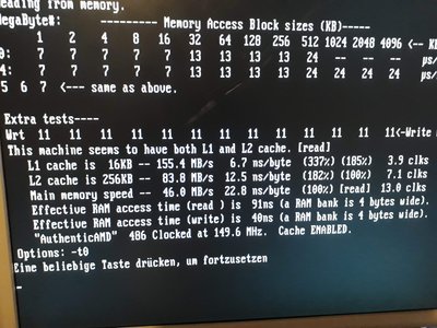

I played with all 3 cache settings a bit.
- Write Cycle on 3 doesn't affect L2 at all, main memory speed drops to 46.1 though.
- Burst Cycle on 2 drops L2 perfromance so hard that cachechk doesn't recognize it anymore, although speedsys still shows a bit of difference in perfromance (was it 65 MB/s I can't remember?)
- Single Cycle on 3 hangs te system on post. I really don't get why.
