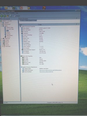

Got my hands on a QuadroFX 3000 (FX 5900 Ultra equivalent).
Here is what everest says.
485.9 KiB
491 views
Yup. 4 pipelines, 8 TMUs, as expected. It also shows 3 vertex and 1 pixel shader, for what that's worth. The specifics of those seem a bit hard to figure out based on other info online.
I will say, I was surprised to see that this card downclocks when not under load. When the fan kicks up to a higher RPM the card is at 399mhz core. When the fan drops to a lower speed the card is running at 300Mhz core. I had no idea the FX series did this. Is this a Quadro feature?
