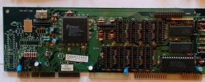

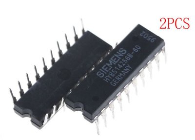

I've got these Siemens ram DIP's. They should match to the Trident VLB card i have got with a 486 bundle.
But what is with the orientation? In which direction shall i put them onboard?
The notch to the north or to the south?

Reply 1 of 2, by cyclone3d
Line up the notch on the chips with the notch on the sockets.
