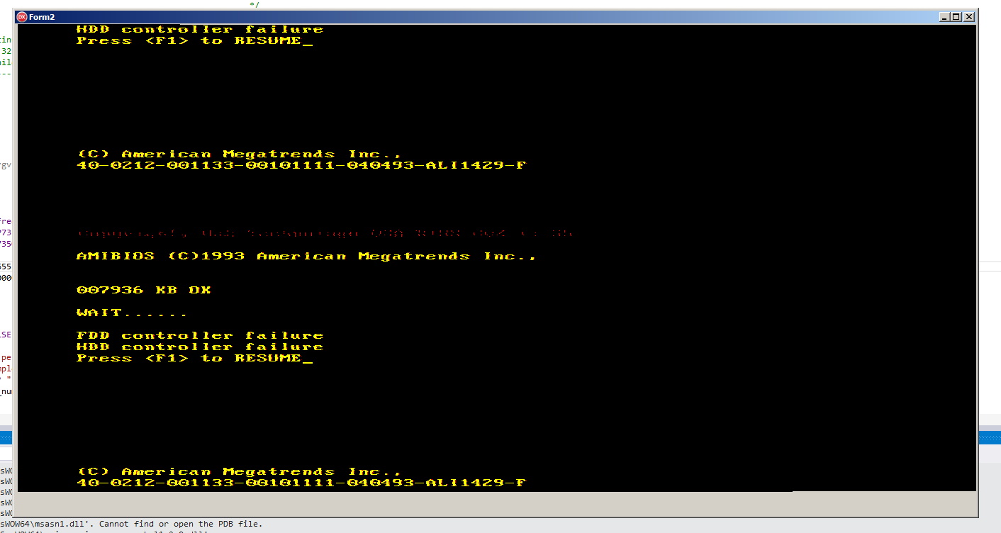

Recently i found ADLink PCIe-7350 which is High-Speed Digital I/O Card. Since this card TTL 5V compatible i was qurious is it possible to capture signal from EGA/CGA video cards.
Today i finished small app (which is just proof-of-concept) that captured and decoded signal from OAK EGA card.
http://f5soft.com/pics/2020-01/EGA1.jpg

I can see some jitter...
EGA dot clock is 16 MHz, that PCIe-7350 apparently works at 50 MHz - still not enough?

Reply 2 of 6, by BreakPoint
Internal clock of PCIe-7350 can generate any clock frequency of 100 MHz / N, where N is any integer from 2 to 65535. So there is no chance to tune it to exact EGA frequency. Currently it runs on 50MHz so some pixels captured 3 times and some 4 times.
PCIe-7350 can also use external sample clock. I think it's possible to sample EGA clock directly from a feature connector. In this case PCIe-7350 and EGA card should work synchronous.
If not then maybe later i'll make up some algorithm to remove jitter.
If i succeed with external clock then basically i can read (and maybe write) any TTL devices like EGA/CGA/Mono card or ISA bus and so on.
If anyone interested i'll keep this thread updated.

BreakPoint wrote on 2020-01-10, 15:26:
Now that's an idea to put one of the RCA connectors on EGA to use - make a plug for the FC that routes the pixel clock to the RCA...
