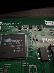

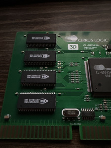

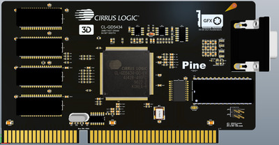

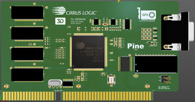

Reply 121 of 132, by cizar
I downloaded the design and made some cosmetic changes to the PCB. I have replaced parts that are not available. I am sending printed circuit boards to be made by JLCPCB. If the creator of the project is interested, I can send the project ...

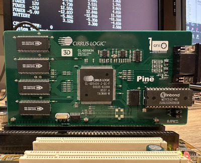

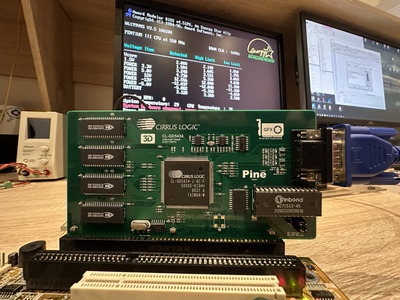

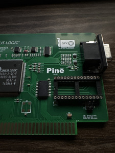

Reply 123 of 132, by cizar
The assembled card works great, I found only 1 error on the schematic.

Reply 124 of 132, by Sphere478
Awesome work! Looks amazing!
