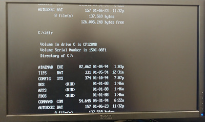

So it arrived yesterday, measured the plug and ordered one off amazon which arrived today. For anyone looking in the future, it takes a 5V 2.6A adapter with a 5.5mm x 2.1mm center-positive barrel plug. Length on mine is 9mm and it's pretty much a perfect fit.
Sadly, DOS input is taken as 640x350 rather than 720x400 and has a pretty severe overscan but you can fix it with the menu a bit. Unfortunately I can't seem to get rid of the vertical overscan. Others/Windows resolutions are practically perfect just by pressing the autoadjust button. Quality overall is leagues better than the cheap aixxco adapter that I previously tried, no grainy backgrounds at all.
I will have to figure something out for the vertical overscan but I feel that's much easier to fix/handle than trying to improve the quality.
Happy with this purchase 😀

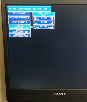

Reply 272 of 318, by dekkit
Just to chime in as ive been on this journey recently... Ive been surprised how challenging it is to get old dos rigs to display properly on most lcd panels (ie parts screen image missing). Ive been using a mix of different lcd 'square' panels with not much joy.
After a bit of disappointment with cheap vga to hdmi (they mostly worked, sharp image but screen was slightly cut off too).
I recently tried the extron 300 - the DVI one as it was about $25 USD
https://www.extron.com/article/rgbhdmidvi300rave
Had to play around with the 'input configuration' menu and mostly with the values for ' start' which resulted in mostly stable results.(see pic for menu)
603.37 KiB
466 views
A few dos games would throw it out at different stages (ie sensible world of soccer - menus fine, but the match would need further manual tuning)
Overall does a pretty decent job.

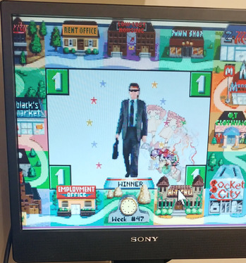

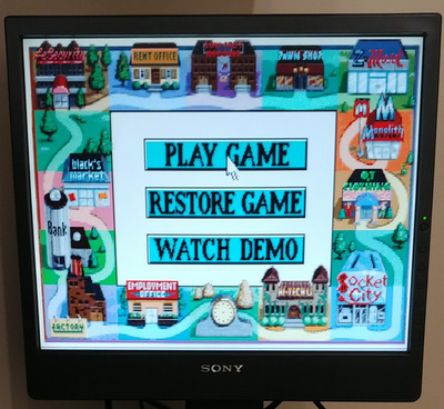

Comparison
Cheap vga to hdmi (ali express) - see left side of screen - missing part of game board.
764.23 KiB
461 views
Extron 300 - entire game board fits
555.84 KiB
461 views

I have tried with GBS-C too (which have VGA input) but no luck.
I have read that people here are quite satisfied by the Extron RGB-HDMI 300a (though it is quite hard ton find in france)
Does the Extron display messages when changing resolutions?

Reply 275 of 318, by dekkit
kwakwak wrote on 2023-01-24, 16:05:
I have read that people here are quite satisfied by the Extron RGB-HDMI 300a (though it is quite hard to find in france)
I have only done limited testing, but with Sensible world of soccer as soon as left the main menu the resolution changed and threw out my tuning.
No messages as such but if you are streaming that may become just as annoying.

GBS Control + HV to C sync Combiner
1.21 MiB
324 views
Dell
Shows a lot of promise with the picture being so much more stable and better with h&v sync converted to singular c sync.
The pic was how it looked on first power up and outputting at 1280 x 960 to my dell wide screen (which would not accept the original msdos vga signal at all originally).
Cant believe how much of a difference just converting hv sync to c sync makes with gbs control.
I need to move and scale the picture a bit but will clean up my prototyping first.

Overall gbs control is a bit more work but the picture quality is shaping up to very decent.
As an aside - i tried the gbs 8200 in its original non-gbscontrol mode - even with c sync it couldnt detect the input.
UPDATE #2
After much further messing with gbs control (moving the Wi-Fi chip further away to improve connectivity, amending the sync combiner circuit to add a 470r on c sync out) this is the best I was able to get it.
The picture sharpness was excellent, but I couldnt figure out how correct the far right of the screen (through scaling and move buttons on web ui) - no matter what resolution.
This is likely a combination my graphics card/chip ( GPU is a CHIPS F65540), lcd monitor, and gbs control.
Note: It displays boot screens, bios, initial dos prompts etc cleanly.
Im not running any gfx driver in for ms dos so that may also be a factor with my video card.
Really recommend trying it again with a sync combiner (XOR method) - it makes a huge/massive difference if you haven't already
