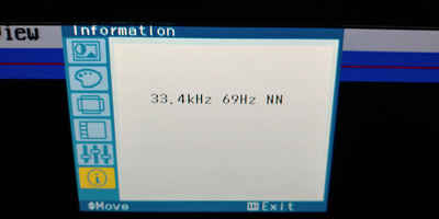

...digging deeper into the 486 'Chips' video card - it has become clearer that it video output isn't to spec.
For MS DOS text mode (assuming 720x400):
Actual (Video= 'CHIPS F65548')
33.4 kHz
69 Hz
Expected (based on what I could find in few monitor user manuals)
31.469 kHz
70.87 Hz
FYI - Here is what my Samsung 940N LCD is reporting - even though it is actually showing the image really well (with no scaler inbetween)
1.05 MiB
793 views
So its important to keep this in mind with any reports (including my own!) that a certain upscaler or even LCD Monitor combination 'didn't work properly' .
Its very likely the lcd screen / upscalers have a tolerance threshold that a non standard signal falls well outside of (hence the need to mess with manual adjustments). CRT screens are not as fussy.
I'm going to see if I can find any ways to adjust / correct/ clean the output kHz and hz on the video card itself or if there is a circuits that may help before I try and scale the image ( if such a thing exists) before plugging it back into a gbs or extron.

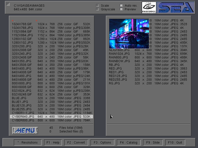

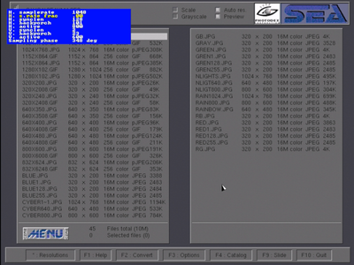

In the topic of this thread, here is a comparison of some text from OSSC 800x600 VGA->digital conversion versus CRT Terminator viewing the same content.
OSSC image has varying softness across the scanline, some columns of text are sharper and others are softer. The image is shifted to the right and cut off, there is a column of black pixels on the left. There is slight banding (in some other images I find jailbars, though this particular one avoids them quite well).
CRT Terminator on the other hand is crisp and pixel perfect in upscaling 800x600 -> 1600x1200 as one might expect.
EDIT: Replaced the OSSC capture with a new one to correct my previous mistake of not manually configuring OSSC sampling settings. For the SEA Image Viewer application, I needed to change H. sample rate in Advanced Settings from 1056 to 1048, H. back porch from 88 to 101, and Sampling Phase from 180 degrees to 348 degrees. (the values 1048 and 101 were analyzed from the input video stream passed into CRT Terminator)

Reply 297 of 341, by maxtherabbit
clb wrote on 2023-02-06, 23:52:
all of that can be eliminated by properly adjusting your sampling settings and setting phase in the OSSC, it is not a plug-n-play device and should not be treated as such
Reply 299 of 341, by clb
To clarify my previous mistake, I took time to configure OSSC sampling to find the best parameters for the same picture. I deleted the previous capture to avoid giving anyone false impressions, and replaced it with an improved capture, which has much better quality.
Verified that the video frame sampling parameters in that capture are correct down to exact clock cycles for this particular video mode (horizontal: fpo:19, sync: 128, bpo: 101, active: 800 and vertical: fpo: 2, sync: 2, bpo: 23, active: 600), and adjusted the other settings so that they give the best result visually. (Maybe the OSSC capture could be still improved further, this was the best I was able to find browsing the different menus)
Thanks maxtherabbit for keeping me from making an ignorant comparison!
