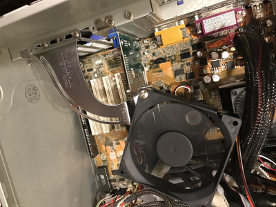

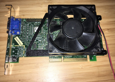

So I'm in full Voodoo 3 preservation mode now because I've run across some bad cards and want to protect the ones that are still functional.

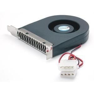

A little while ago, I posted a picture of a quick-and-dirty mod where I zip tied a fan to the V3 heatsink. It still works pretty well. I was running loops of the Unreal flyby as a stress test and noticed that the card's reverse where the GPU sits on the other side gets really hot too. Is it overkill to cool this side of the board too, maybe with a case slot fan that looks something like this?
7.86 KiB
780 views
My question is, for those who own a fan like this, which direction does the air flow?
Here's what the setup looks like inside of the case. I'd want the air flowing down onto the back of the card, obviously, so I wouldn't buy one if it shot air upward. Thanks!
Reply 2 of 34, by Doornkaat
chrismeyer6 wrote on 2020-05-12, 16:19:
The few that I have are all exhaust fans they push air out the back of the case. It probably wouldn't hurt to try it and check temps
This. By design those centrifugal fans can only work like this.
However they can still generate sime airflow over the card and it probably won't take much to cool the backside.
You can also equip your V3 with a heatsink and fan combo intended for chipset cooling to cool the backside of the PCB. Just use a thin electrically non conductive thermal pad for electrical insulation between heatsink and PCB since there are exposed pads.

Most I seen like the one you posted blow air out the back.

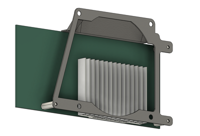

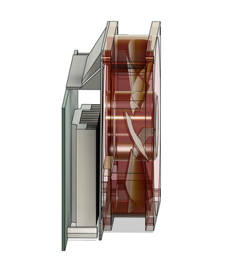

I was trying to solve this problem last week too - I made some fan adapters to fit a 92mm or 80mm fan to the card. It's about the same as zip tieing a fan to it, but attaches securely to the board holes with some 10mm (2000) or 15mm (3000) "m3 hex spacers". I've attached the STL files if anyone would like to print one out for themselves 😀
My card was still pretty hot to the touch on the back even with this fitted with a reasonably fast fan. Given you've also got trouble with that, and the back of the card has a non-solder-masked area on the back of the chip, I wonder if putting a heatsink on the back with some thermal tape might be beneficial?

Wow, that's fantastic. I have a 3D printer and will be printing off some of these very soon. May even use my special silk gold filament. Thanks!

Glad it's useful to someone 😀 I'm working on one for the PCI card now
I recommend using PETG or ABS if possible, though it's purposely designed to be away from the card & heatsink, PLA can get a bit floppy if it's over maybe 50c - the other day I made a monitor stand part out of some dark grey PLA and it melted downwards just from the sun shining on it 😒
The standoffs screw into the fan mounting plate - the holes are threaded for M3 screws, then the fan adapter screws onto the card.

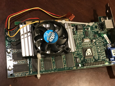

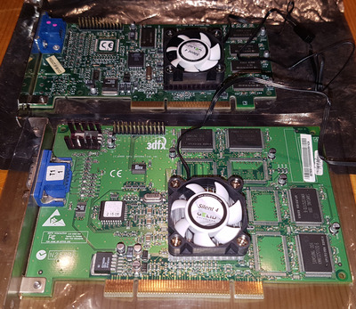

I only installed a small 40mm case fan on both of my voodoo 3 cards. One of them is made by stb systems and one is 3dfx interactive card.
I hope that is good enough cooling for them.

Thanks. You can't really tell from the first photo, but I did install a fan on the heatsink with zipties. I was hoping to find a way to cool the backside of the card too (can't hurt), and there are some great suggestions in this thread.

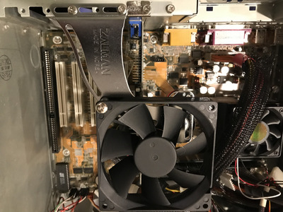

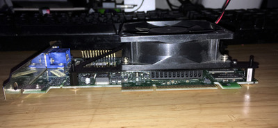

Got it installed today. Overall, I'm pleased with this solution. The fan blows a ton of air down onto the V3, cooling both sides of the card. I'd venture that the fan I ziptied to the heatsink might not even be necessary, but I'll still keep it there.
1.47 MiB
523 views
You can rotate the fan around that single pin that attaches to the arm.
The only downside is that the arm takes up almost all of my slot area. This isn't a deal breaker because I usually have only the AGP card and a sound card, and I have one ISA/PCI shared slot at the end of the case. It would be a problem if I wanted to have a PCI and ISA card installed at the same time. But I can always manually switch them out, and having more peace of mind when it comes to my V3s is the most important thing with this build.
I can also experiment with attaching the fan to the other grooves and may be able to free up an additional slot that way.
