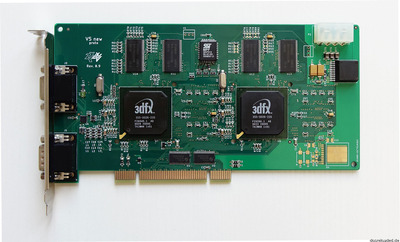

Some italian Guy started to recreate the V5 :

Interesting concept of the pass-thru VGA. But personally I would prefer AGP 1.5V compatible V5 with standard VGA + DVI and perhaps 2x 64 MB RAM. 😁
Reply 3 of 15, by The Serpent Rider
More compact Voodoo 5 with DVI would be much better. Then again, it's not like we would see it at reasonable quantity or price any time soon.
Reply 4 of 15, by havli
Yeah, most likely this project will end up like every other modern Voodoo remake - few prototypes, some photos and thats it.
Reply 5 of 15, by RaverX
Looks nice, but it will be more expensive than "a real card", if it will be available. 2 VSA-100 chips, fast SDRAM memory, PCB, various components, etc. Sure, if it will be "mass produced" it won't be expensive, but are there enough VSA-100 chips available for that? And is there enough demand? Sure, almost any video card collector will want one, but how many are in the world?

Reply 10 of 15, by matze79
The Chips he used on the Bus Interface look same like on Radeon 7000 PCI which in Fact is a AGP Card with some Converters on it.
Also a new Card with 1 VSA and less cost would suffice, i rather would prefer Digital Output, instead of SLI.
1 VSA should be enough for all Glide Titles 😀
Co2 - for a endless Summer
Reply 13 of 15, by WarhammerTH
I'm interested in how he did the design, did he has a reference design or spec for the VSA-100? There is no spec to found in internet.
Or did he completeley reengeneerd the layout and estimae the functions of the pins.
I would be very interested in the schematics of the design, maybe its possible to add some DVI or HDMI via some small FPGA or something
Reply 14 of 15, by sdz
For adding DVI to a VSA card, there is no need for an FPGA. A TMDS encoder, such as TFP410, will do the trick. It might not be register compatible with the SiI164 used on the original DVI V4/V5 cards, but that can be easily fixed.
The databook for the VSA100 is available online, it contains most of the info needed to make a new card.
Reply 15 of 15, by WarhammerTH
Thank you @sdz for the keyword databook, now i found very fast. Never heard this word. I just looked for datasheed, reference designe and so on... (i don't want to make a new card, just interested)
