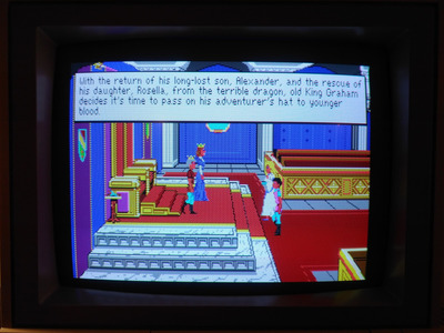

And this is a screenshot of the King's Quest IV (SCI) Demo displayed on a Commodore 1084 screen via ATI "Small Wonder" Graphics Solution v.1:
568.33 KiB
1951 views
King's Quest IV (SCI) Demo on 1084
It is updating the screen surprisingly fast, as well. The machine is a double-speed turbo XT (PC 20-III).
Reply 30 of 134, by root42
This is sooo cool! How did you wire up the 1084? That would make for an awesome CGA monitor.

Reply 31 of 134, by Benedikt
I wired it up with a DE9 to circular 8-pin DIN cable to its digital RGBI input. More accurately, I took a serial cable and replaced one of the plugs.
The 1084 is actually the CGA monitor recommended in the PC 20-III's manual.
