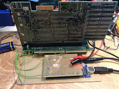

Hardware-wise I've connected:
- GND, VCC
- D0-7 to a port on the Arduino
- A0-A19 to 3 ports on the Arduino
- IOCHRDY is connected to a pin on the Arduino
- REFRESH is connected to VCC/5V via a Resistor
- ~MEMW, ~MEMR, ~IOW, ~IOR to pins on the Arduino

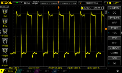

- OSC is connected to a square wave oscillator (14.31818MHz, 5V amplitude, 2.5V offset, normal TTL signal)
- CLK pin is unconnected (it's also unconnected on all of my ISA VGA cards).
- (B)ALE pin is pulled HIGH permanently in software (see http://www.malinov.com/Home/sergeys-projects/isa-supervga, v1.0 Errata)
- AEN is connected to the Arduino and pulled LOW in software permanently.
- RESET is also hooked up to the Arduino and gets pulsed at the initial init.
Notes:
- Only 8 bits of the data bus are used (the 16bit part is entirely unconnected)
- I'm missing the -12V and -5V rails. These don't seem to be connected anywhere, though.
- I have tested the cards for 8-bit mode compatibility by covering the 16bit pins with tape and testing them in a regular PC.
I've attached some pictures if anyone is interested in the setup:

You have multiple issues that seem to point in the same direction: Somehow, the card does not make progress (does not generate video timing; does not release IOCHRDY). To make progress, the card needs a clock. The clock on those cards is either driven by on-board crystal oscillators or by a frequency synthesizer chip driven by the ISA OSC signal. On a standard VGA cards, only two of the four possible clock settings were valid, chosing other clock settings might result in the chip not getting any clock signal. So my recommendation on this one is:
  1. Double-check that the 14,318MHz oscillator on OSC does actually work
  2. Log write access to port 3C2. The bits that remain after masking with 0x0C select the clock. 00 means 25MHz, and 04 means 28MHz (approximately; I'm too lazy to look up the fractional parts). If 08 or 0C is written into that register, the card might end up without a clock.
Reply 18 of 48, by manawyrm
Hello mkarcher,
thanks for all that info, very helpful 😀
I've gone ahead and checked the 14 MHz oscillator and it was looking a bit to sinusoidal for my taste, so I've built a simple buffer with a 74-logic gate that made it a pretty perfect square wave again:
35.6 KiB

mkarcher wrote on 2020-09-03, 16:44:
Sounds like it probes for an MDA card
Hm, the data bus and the IOCHRDY line are pulled up by my MCU, so the video card has to decode the address at 0xB0000 and pull the line actively low (it's at 0.00V in that state).
