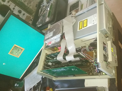

I must show my computer at current state.
Data:
486DX2-66
8x 4MB FPM 30 pin memory. (32MB ), actually 16MB, keep boot up time short (for debugging ist memory ticking too loong and make me isane 🤣 )
Advanced Integration Research 486UL Motherboard with UMC480 chipset (bad memory performance)
NE2000T-1 (orginal Novell) Network-card with XT-IDE-bios (386-mode) instead NE2000 Boot-ROM.
Creative Soundblaster16 CT2290
Hameg Ho80 (GPIB Adapter based NEC µPD7210 , it is important for my main hobby, test equipiment gears)
VLB Multi-IO-Card, someone with Winbond controller, fast PIO Mode 4.
Harddisk: Quantum Fireball 1.6A (Win95.0) or WD 644a (6,4GB, Win 3.1)
Case: Highscreen kompakt Serie II, hood-case is not missed. 😉
I haven't paid for this hardware, most was gift / dumpster diving. Motherboard and CPU are in my hand over since 20 years ago.

Speedsys result with AIR 486UL Motherboard, very disappointed performance, a 386-chipset. *shrugs*

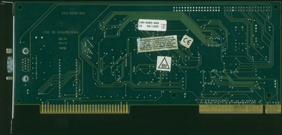

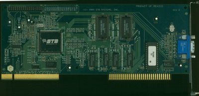

I am one person who has the STB card. How zoomed in do you want the pics? I can also take some backlit pics if that would help with seeing the traces inside the board.
I'll put the pictures on my Google Drive so you can get the full resolution pictures instead of the crap compressed pictures.

Reply 26 of 59, by cyclone3d
Here are the pics - forum compresses a ton so don't be surprised if they look crappy on here:
535.65 KiB
773 views
505.56 KiB
773 views
And the Google Drive link to both the 100% jpegs and the full size 600dpi PNGs:
https://drive.google.com/drive/folders/1OESRI … HxQ?usp=sharing
If the stickers on the back are in the way, let me know and I'll remove them, take another scan and then put them back on.. probably in a different place.

Reply 27 of 59, by Madao
Thanks !
PIcture resolution is more than good for researching of SAUP decoder.
But now i have a bad feeling: Trio64 compatible mode.
I found only one SAUP decoder (74F260, 2x 5-input NOR )
Pleas wait, i'll decoding config resistor strap. Then i can make: Virge VL based STB card or new (minimal) draft.

Reply 30 of 59, by mkarcher
Madao wrote on 2020-09-22, 03:29:
While this is right, the chip is still most likely operating in LPB mode: You can trace out pin 50 of the Trio64V+ to be connected to the trace that snakes between the RAS/CAS termination resistors R37-R40, and finally leads to the via right of the VL slot. You can follow the trace on the "solder side" to lead up to another via which is then connected to VL pin A30 (address 30) on the component side again. So SAUP2 == A30, without any further decoding. So for normal addressing, SAUP2 is always zero, which means you can't reach "register/port access". I can't find out what to make out of this (the registers/ports must be accessible without going to 1GB), but I guess that SAUP2 is enabling the memory mapped registers which you get at MMIOBASE + 16MB in PCI configurations. On this card, memory mapped registers will be above 1GB then.
Some of the NOR pins are obviously wired: Pins 1-3 of the NOR gate are connected to address pins A23, A24 and A25. A26 and A29 go beneath the 74F260 chip. It would make sense to have them connected to pins 12 and 13. It's interesting that A27, A28 and A31 are not decoded at all. The output of the decode (1 only if all inputs are zero) is on pin 5 of the NOR gate, and the trace from pin 5, winding around pin 6 is likely the one connected to the via above pin 10, which goes through a via to a place benath the Trio64V+ that is suspiciously near to pin 25, so a connection to SAUP1 is very likely. This means that the card decodes the range 0..127MB (using A2..A26); mirrors of the video memory at A0000h is thus expected to appear at 080A0000h (128MB + x), 100A0000h (256MB + x) and 180A0000h (384MB + x). Interestingly, A27 is decoded, so no mirror images at 512MB, 640MB, 768MB and 896MB. If someone has an idea which conflict they are avoiding by keeping that memory range clean, I am interested in ideas. I don't think it's the Weitek 4167 interface area, as that area starts at 3GB.
The trace coming from the top and and entering the area beneat the 74F260 is likely connected to the via beneath that chip which is connected to a trace that connects to another via near the drilled hole and connects to C32/R21. In that case, it is unrelated to adressing. For the second NOR gate in the 74F260, I see three inputs connected with a thick trace (trace configuration for power traces, so very likely GND), so the second NOR gate has at most two inputs in use, the ones on pin 8 and the one on pin 4. Maybe the second NOR gate is completely unused after all.
