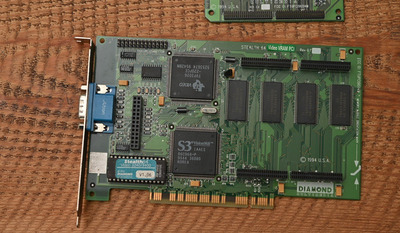

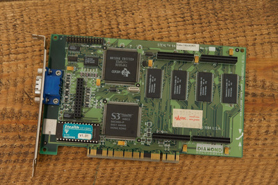

Reply 48 of 59, by mpe
I happen to own Diamond Stealth 64 Video PCI in both 175 and 220 MHz TI RAMDAC version:
327.86 KiB
729 views
333.92 KiB
729 views
There is hardly any difference in quality. The later can do 1024x768 @ 120 Hz, 1280x1024 @ 100 Hz and especially 1600x1280 @ 76 Hz which was a big deal back then in CRT era.
The IBM part can be had in either IBM RGB514 (170 MHz) or RGB524 (220 MHz) version and I think I've seen them both on a Stealth64 VRAM card.
