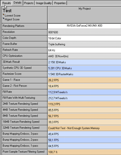

In 3D Mark 99 (800x600) I got a score of 1465 3D Marks / 4272 CPU 3D Marks with the Geforce2 MX400.
Just dug out my results. "My Project" is the SiS540 benchmark. Looking at your comparison to the GF2 MX400, I'm starting to think there was something horribly wrong on my system!
9.66 KiB

Reply 31 of 41, by RetroSpector78
Pierre32 wrote on 2020-10-25, 00:38:
Well here are mine (ran on my AMD K6-2 400 clone .... on the packard bell results are a lot worse) :
18.49 KiB
365 views
My Packard Bell uses the SIS530 chipset (SiS 6326 IGP).
Your SIS540 uses the SIS 300 IGP. According to Wikipedia :
Following the successful SiS 6326 in 1998, SiS introduced the SiS 300 as its replacement. The 3D performance was improved 5 times over the previous GPU, although still considered slow, yet a value solution as a display chip for users that don't use 3D-intensive applications.
Now I am surprised that it scores so high in 3d mark. Are you sure it rendered everything correctly ? Because that is not such a bad score.
