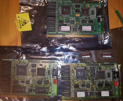

Small update:
These are the 3 speedstar cards that I currently have:
1.76 MiB
350 views
Bottom left one in the picture is the one that does not work and it used to have those bios chips that are now in bottom right one and those bios chips that are not on a card are the ones that used to be in bottom right one. I assume I can't put the chips that used to be in bottom right card into the top card because it has different ramdac chip?
Main thing I wanted to give an update with is that the bottom right one works fine with the bios chips that I took from the broken card so at least it wasn't the bios chips that were broken on that card. At least switching bios chips between these 2 cards seem to have worked fine. I am still waiting for the programmer from China that I ordered from ebay.

Reply 24 of 57, by Grzyb
Baoran wrote on 2020-11-11, 00:58:
Probably not, but feel free to experiment.
There's some chance the BIOS includes support for various RAMDACs, and auto-detects them at run-time.
If not, I expect the following symptoms:
- modes up to 256 colors working fine
- can enter the 24-bpp mode, but with some garbage on the screen
- 15-bpp modes may display garbage, but may also work OK, if that SS2410 chip happens to be compatible with Sierra

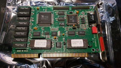

I've posted this here somwhere before but I might as well again.
Diamond SpeedSTAR24 (ET4000AX).zip
38.66 KiB
19 downloads
my card has a Samsung 18bit(?) 8bit DAC
some people here have said it's a 8bit DAC but the datasheet says: 256x18 LUT, 3x6bit D/A
238.59 KiB
224 views
Reply 35 of 57, by Grzyb
imi wrote on 2020-11-17, 02:11:
my card has a Samsung 18bit(?) DAC
KDA0476 is 8-bpp, out of 18-bit palette
ie. standard VGA
