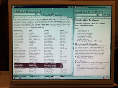

Latest driver MGA Powerdesk 4.31.041. has some glitches in D3D on DungeonKeeperD3D as I reported earlier (Flickering lights, Flickering Dungeon Heart), but also has glitches on some! Textures in Jedi-Knight.
Though I have JediKnight 1.0 perhaps that's the issue. But I also checked the Texture-size to be "8" instead of "1" as recommended for that card. But it's still broken...so I have to check the drivers and the games again.

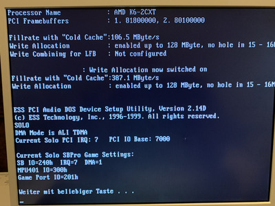

Reply 22 of 33, by dr.zeissler
Here is how I activate write-combining. Very simple, but if it's 100% correct...I don't know, but it seems to work.
Beside that JediKnight-DF2 and JediKnight MOS list MatroxMystique as official supported.
I have Version 1.0 of both (DF2/MOS) and the latest driver that does not break direct-draw accerlation has some texture-glitches on both supported games.

Reply 23 of 33, by leonardo
dr.zeissler wrote on 2022-01-06, 19:24:
I can't tell from the output if you've got it properly configured or not. The last screenie does show two PCI framebuffer ranges (these would have to be checked against what is shown for the Mystique in Device Manager). Also a bit lower it says that write combining for LFB (= linear framebuffer?) is off. Maybe you have it set up just how it's supposed to be, but for me it would be easier to read if you posted a screenshot of CTU after Windows had started, because that's what I used.
You would also have to have some kind of benchmark tool to be able to tell if the tweak makes a difference or not. I used 3DMark2K, but given your card, you may have to choose something older.
[Install Win95 like you were born in 1985!] on systems like this or this.

I'll upload the texture glitches the mystique makes on DungeonKeeper1 and JediKnight. It's obvious a driver issue.
In earlier driver versions it's OK but the later drivers are broken on some textures in some games.
Beside that I must have to use the latest driver because scrolling is broken on the earlier ones. Perhaps a chipset issue?

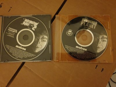

Reply 26 of 33, by AppleSauce
Oh man that's some nostalgia right there , I had a matrox mystique in the home pc when I was a kid , we had some sort of pentium 2 or 3 rig cant remember the details , It came bundled with a buncha matrox specific games. I do remember running some other non matrox stuff like gta 1 and croc 2.
Still have the cds , I think there's a mechwarrior 2 one lying around somewhere as well. They're all scratched to hell and back though xD.
Btw I think that matrox jester is hella creepy.
1.34 MiB
938 views

- works only with the 1997 driver without issues (370)
- later versions have: texture-glitches while moving towards walls/textures. only some textures are effected but it obvious. ***FIXED*** value "32" in min Texture-Sitze Option!

I have another machine to test this...we will see...
I found a sulution for the StarWars Jedi Knight Games. There is an Option "min texture-size" or something like that.
With other cards like PVR you have to put a very small number in that e.g. 1-3... the mystique requires "32" as value to not produce texture-glitches.
So there is only DungeonKeeper1 to be fixed with the latest (and best!) mystique driver. Hopefully I find a solution for that too...
