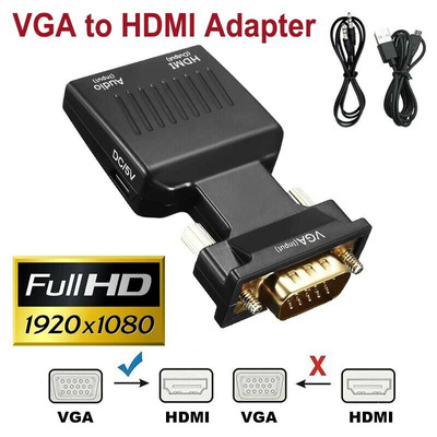

Reply 8 of 8, by Pierre32
I've had no issues capturing BIOS & POST screens with an Extron RGB-DVI 300, and more recently an Epiphan DVI2USB 3.0. I even had success with one of the $12 cheapies pictured below, but buyer beware as the internals can vary and not everyone gets the same results.
