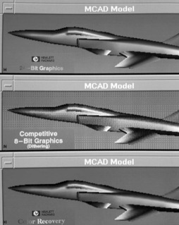

Speaking of crazy 24-bit video hacks https://en.wikipedia.org/wiki/HP_Color_recovery 'near 24-bit' color look from an 8-bit framebuffer. Similar concept but taken to the extreme, why store 24 bits in 32 bits if you could store it in 8 😀
Reply 14 of 25, by Kahenraz
HP Color Recovery is very interesting. I couldn't find any color examples, but I did find a PDF with a grayscale one.
