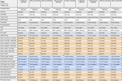

Reply 7 of 25, by agent_x007
Always check core and memory frequency card was tested at :
29.74 KiB
1685 views
Driver/OS : 93.71/WinXP x86 SP3
CPU : Phenom II 965 @ 3,6GHz (2,4GHz NB)
RAM : 2x2GB 800MHz CL4.4.4.12
MB : AM2NF3-VSTA (BIOS "P3.30")
Reply 8 of 25, by Kahenraz
That's a really good chart. It also shows that the 5200 is still very competitive compared to the 5600, except for those special situations where it is not.

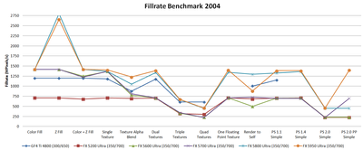

Reply 9 of 25, by agent_x007
Thank you, but about that 5200 vs. 5600 being close... (here's frequency matched) :
63.2 KiB
1673 views
5200 drops the ball vs. 5600, where Pixel Fillrate is important/needed (no color compression on former is really painfull).
Reply 10 of 25, by Kahenraz
Yes, it's true. You can compensate for it somewhat by lowering the resolution. 640x480 and 800x600 is still pretty good for a lot of older titles. 1024x768 can be much more challenging for later titles though.
It's a good card if you use it for older titles. It never was of any value for DirectX 8 or 9, other than for the novelty.
Another use case is to use it for additional display outputs for multiple monitors. There's no shame in using it for that.
